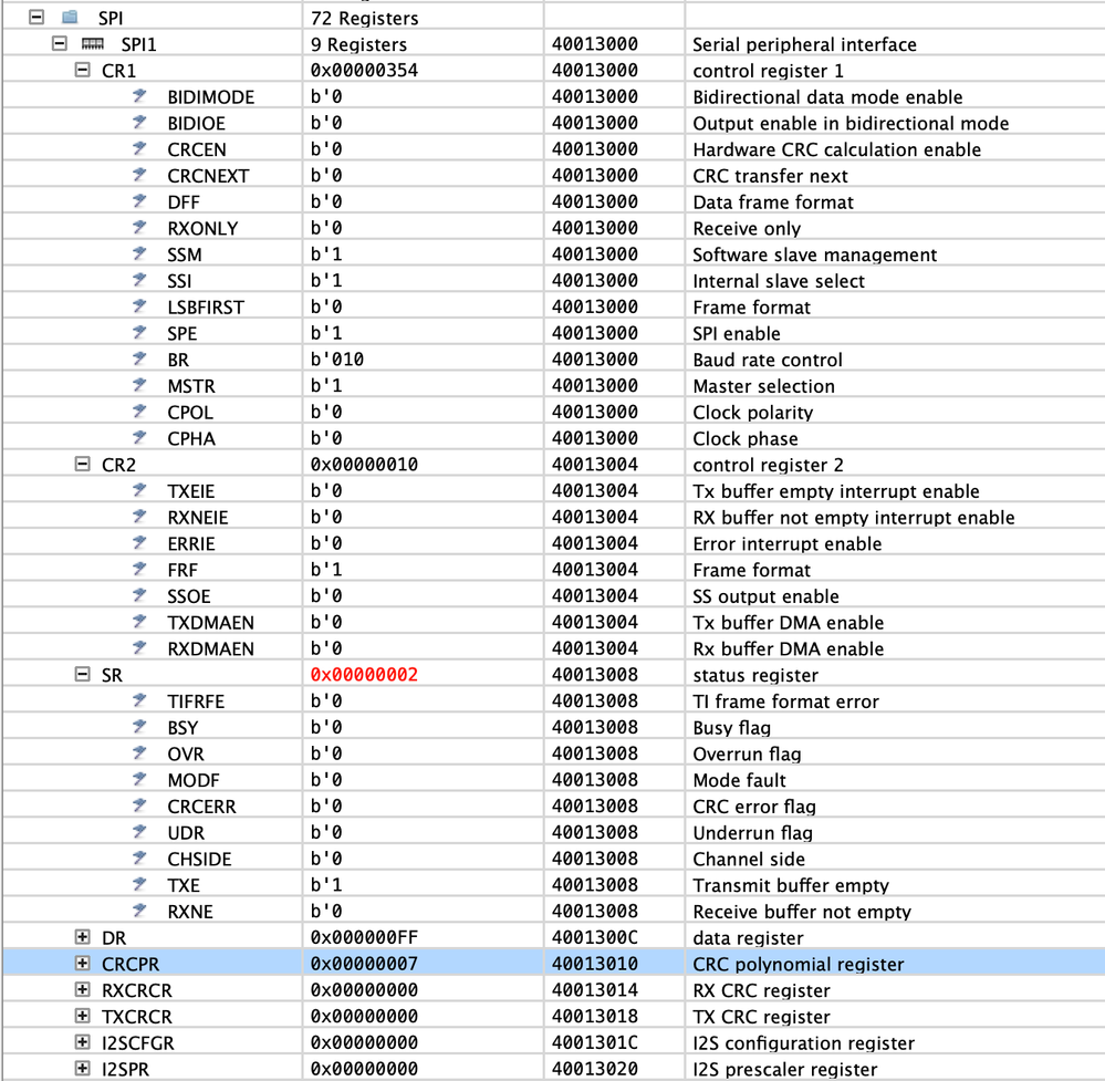

2020-07-28 6:09 AM
Probably a bug in your code. How does the registers content look like?
2020-07-28 6:16 AM
2020-07-28 6:44 AM
It was bug in my code obviously. TI mode seems to use 9clock cycles for 8bits of data. Switching to Motorola mode fixed this issue.
Problem with setting the motorola mode in the first place was order of the commands that were sent to the CR register.
setting master was just bellow enabling of the SPI peripheral. But setting of the frame mode for some reason was enabling the master mode ?!
Anyway, moving enable command fixed the setting of Motorola mode.
