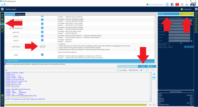

For anyone with this same issue, in STM32CubeProgrammer,in the top right, there's a blue drop down menu. Select ST-LINK (if using that to connect to your device) and click the green connect button. The log should show test indicating a connection was made.
Click on the OB tab on the left. Under user configuration, scroll down to NRST_MODE. In the drop down menu, select 2. Then click the apply button. You should get a message that says "Option Bytes successfully programmed".
That's as far as I've gotten, but I assume the reset pin should be able to be used for other functions now.
