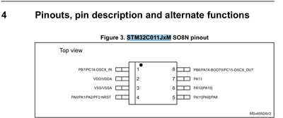

Even in the 8‑pin SOIC package, the STM32C011J4M6 exposes the full SWD interface.
| SWDIO | PA13 | Bidirectional debug data |
| SWCLK | PA14 | Debug clock |
| NRST | PA0 | Optional but strongly recommended |
| VDD / VSS | — | Power + ground |
These are the same pins used on all STM32C0 devices.
You’ll want these three documents from ST:
Datasheet (STM32C011x4/x6)
Reference Manual (RM0490 — STM32C0 series)
Errata Sheet (always worth checking)
You can find them on ST’s product page by searching “STM32C011J4M6”.

@Glodhi wrote:1. Please suggest ... documents
See the 'Documentation' tab of the Product Page:
https://www.st.com/en/microcontrollers-microprocessors/stm32c011j4.html#documentation
The key documents are the Datasheet and the Reference Manual.
For software & examples, see the 'Tools & Software' tab:
https://www.st.com/en/microcontrollers-microprocessors/stm32c011j4.html#tools-software
You can access examples via STM32CubeMX
