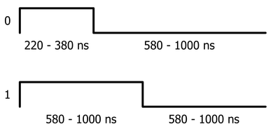

I'm trying to talk to a string of WS2812C LEDs with an STM32C011J4M6. The timing requirements are:

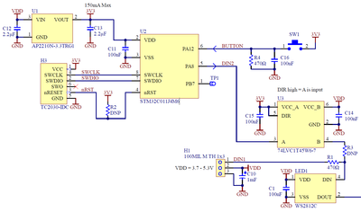

Here's the schematic. I populated R3 and removed R1:

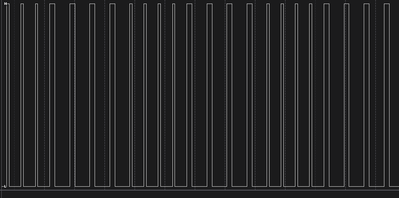

My problem is that, when I try to output a string of 1s, the timings vary despite the code being the same for each bit:
I get 4 short pulses (840ns, good) followed by 4 longer pulses (1670ns, too long). Somehow, ~45 extra clock cycles are embedded in the long pulses, which doesn't make any sense since the code is the same for each bit.
Is the microcontroller doing background tasks or something? Why is the timing different in such a predictable way?
