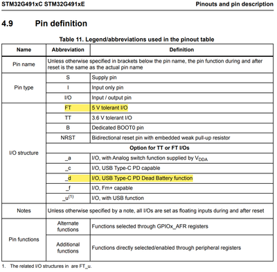

It is already mentioned in footnote 5 of table Table 12. STM32G491xC/xE pin definition in datasheet. After reset, a pull-down resistor is present because of the electrical characteristics of DBCC pins.
Also caution is mentioned in FAQ: Using dead battery pins in an STM32 with an i... - STMicroelectronics Community
User should be aware of differences in output timing, speed, and leakage for FT_c FT_d GPIOs compared to standard GPIOs.

These all are valid points; however, what I had in mind more than anything else is that the 5k1 pulldown on CC pins are controlled by level at the DBCC pin, and that creates surprising effects if one is not aware of this. In particular, e.g. in 'G4, PA9/PA10 are UART bootloader pins AND DBCC pins too, "controlling" PB4/PB6 CC pins, so if there's something critical at those pins (e.g. power control), that might result in nasty surprises, unless the bootloader switches this off.
