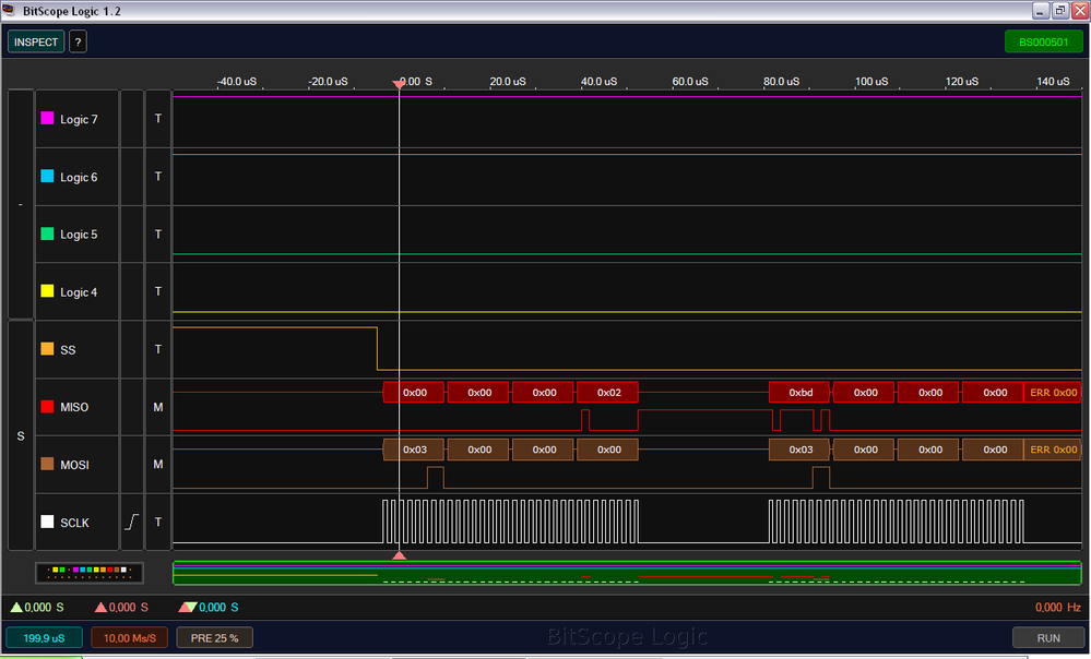

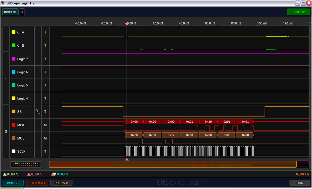

2017-07-15 7:56 PM
I had to face the same problem, but on the STM32F105, SPI master + DMA and hardware NSS.
Before I had found the issue it looked like this
After reading the discussion I realized that disabling the SPI in DMA callback resolves the issue.
static void SpiCallback(SPI_HandleTypeDef *hspi)
{ __HAL_SPI_DISABLE(hspi); // disable NSS };void HAL_SPI_ErrorCallback(SPI_HandleTypeDef *hspi)
{ SpiCallback(hspi); };void HAL_SPI_TxRxCpltCallback(SPI_HandleTypeDef *hspi)
{ SpiCallback(hspi); };void HAL_SPI_TxCpltCallback(SPI_HandleTypeDef *hspi)
{ SpiCallback(hspi); };After that transmission looks like this.
I hope it will help you.
