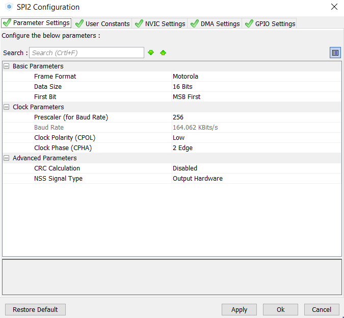

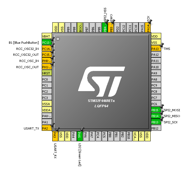

I'm configuring the Nucleo 64 with the STM32F446RE to use SPI as a Master.
The problem I'm having right now is that the NSS pin is always low. Clock and MOSI are perfect. What I would like is that the NSS is high, and goes low during the transmission, then high again.
I've tried setting the NSS as Hardware output, and Software in Cube, but still failed to get what I want.

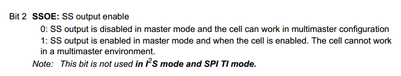

I think this configuration should be sorted with the following 3 bits, from CR1 and CR2. Right now Cube is setting SSOE= 1, SSM=1, SSI=1. And the NSS pin is configured as hardware output in Cube.
Any clues on how should I setup this? I would like to avoid having to use a random pin as CS and pull it manually.
Thanks!!

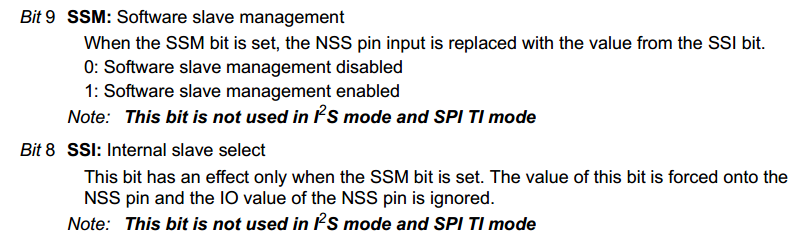

There's no such functionality in the F4 SPI. In some other STM32 families, NSS may be active only during transmission, but then also toggles between frames (bytes), which may not be what you want either.
You have to do this 'manually', setting the NSS pin as GPIO output. Don't forget the NSS input signal into the SPI module needs to be low (internally) low even if set to soft-NSS.

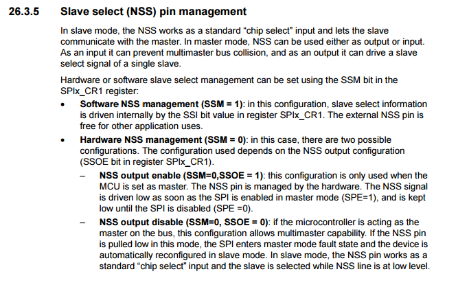

You may assign NSS as GPIO CS, as the reference manual RM0390 says for Hardware NSS management (SSM = 0) that:
NSS output enable (SSM=0,SSOE = 1): this configuration is only used when the MCU is set as master. The NSS pin is managed by the hardware. The NSS signal is driven low as soon as the SPI is enabled in master mode (SPE=1), and is kept low until the SPI is disabled (SPE =0).
Imen

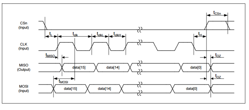

So if I want to implement a simple 16bit spi protocol, as shown (AS5048 encoder), I have to do it manually?
This would negate all advantages of using DMA since I still have to poll the busy flag to set it high again.

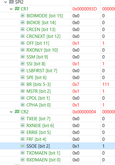

Hi Imen, thanks for your answer.
To my understanding, that's what I'm doing in Cube :
And checking the CR1&2 register values after init, it all seems ok, as shown. However, the NSS pin is driven low and stays there.
Any clues?
