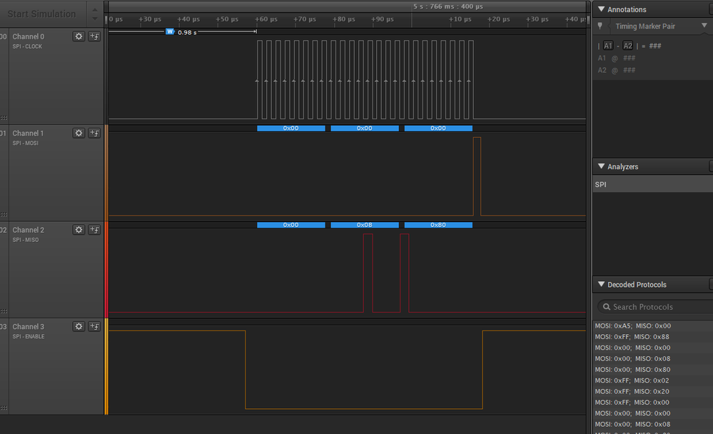

I'm new with the STM32F767ZI (Nucleo board) and tried to write a SPI driver with DMA access.
It works so far, but I have some stupid things on my log, I can't interprete. Is anybody there, who knows what there is going wrong?
I'd like to send three bytes and everythings works fine so far, but after the last byte the software/hardware added a additional signal on the MISO line.

2020-06-25 12:37 AM
What stupid things? What log?
Changes in MOSI don't matter as long as there are no clocks. If you disable SPI after transfer it threestates it's pins, so if you want to avoid that, don't disable SPI.
Using any "library" in your code is your responsibility, so get a full understanding of what they do, or simply don't use them.
2020-06-25 12:45 AM
Hi JW,
thanks for your reply.
I will test, not to disable the SPI after tranfer. We will see, what happens.
My problem is, that I don't know, if the connected device will react to this signal on the MISO line.
Michael
2020-06-25 7:01 AM
There is nothing invalid about the signal you're showing. The device only registers a bit on MOSI on the rising edge of SCK.
I realize the pulse is not needed, but it's not hurting anything. This question has come up from time to time.
