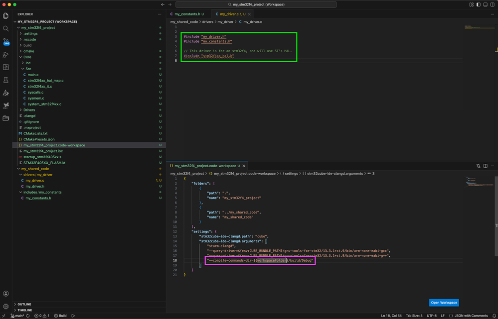

Hi, I am really struggling to get clangd to work correctly in a setup I am trying to get going. I'm new to this VSCode workflow, and am finding VSCode seems to have a lot of persnickety behaviors that really require a lot of specificity to get things working right.
Here is what I am trying to do:
I can get this setup compiling fine, but clangd is complaining about various #include files in my shared code area. I understand that the reason for this is because there is no .clangd file in my shared_code area, so clangd can't "see" it from my project area. Intrepid internet searching has led me to adding this to my code-workspace file:
"folders": [
"name": "stm32_project",
"path": "."
"name": "shared_code",
"path": "../shared_code"
"settings": {
"stm32cube-ide-clangd.arguments": [
"starm-clangd",
"--query-driver=${env:CUBE_BUNDLE_PATH}/gnu-tools-for-stm32/13.3.1+st.9/bin/arm-none-eabi-gcc",
"--query-driver=${env:CUBE_BUNDLE_PATH}/gnu-tools-for-stm32/13.3.1+st.9/bin/arm-none-eabi-g++",
"--compile-commands-dir=${workspaceFolder:stm32_project}/build/Debug"
"stm32cube-ide-clangd.path": "cube"
}It is my understanding that this *should* work. What I find, though, is that I need instead to either change that --compile-commands-dir to:
"--compile-commands-dir=${workspaceFolder}/build/Debug"OR provide an actual absolute path to my project folder. If I do either of those things, clangd works fine.

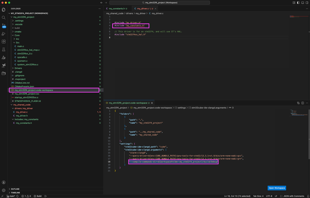

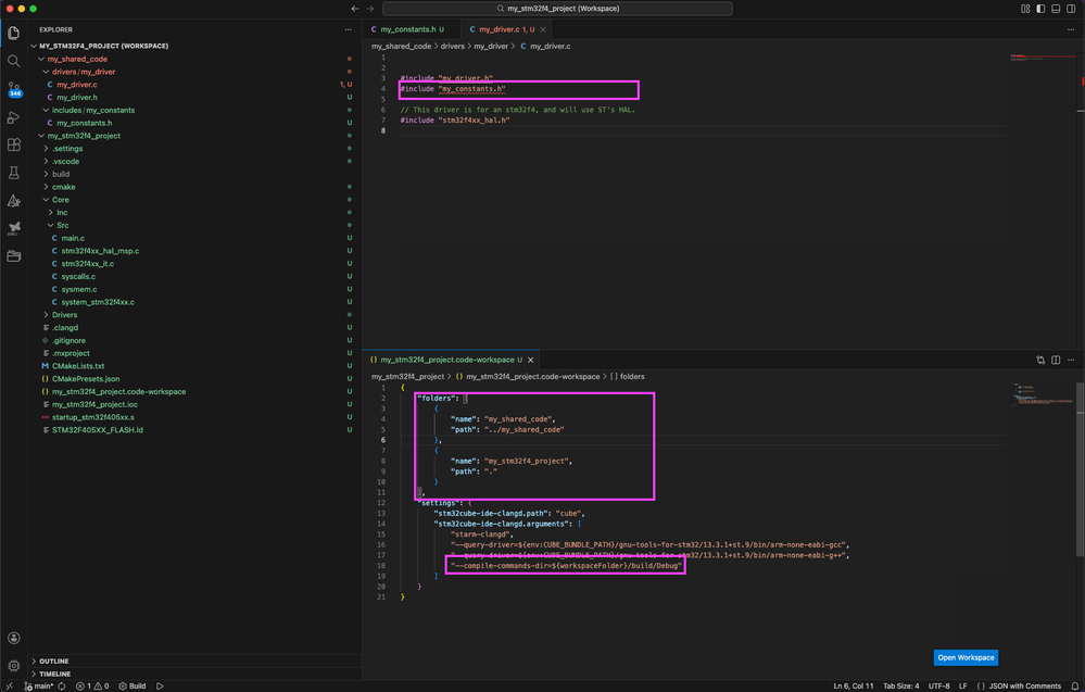

However, I notice that if I reorder the folders in the Explorer view like so:
"folders": [
"path": "."
"settings": {
"starm-clangd",
}clangd breaks again.
It's my understanding that the way around this is to use the "workspaceFolder:stm32_project" syntax, to be specific about what folder my compile_commands.json file lives in.

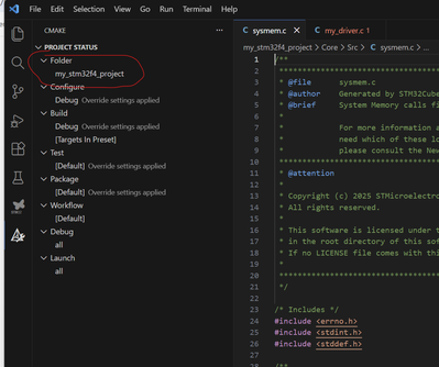

The virus scan of your attachment completed and I managed to obtain a copy. After extracting and creating a workspace on the two folders I can reproduce your problem, and I believe I have an idea how to go about it.
When you use a multi-root workspace (that's the official term btw) then CMake Tools "reconfigures" itself based on the file you have open in the editor, and the location of that file in the overall scheme of things.
As an example, if I open the "sysmem.c" file and look at the CMake tab, I can see this:

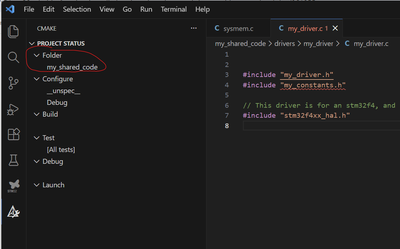

If I swap to "my_driver.c" the extension's state changes accordingly:
As you can see, the "configure" section of the second file shows "__unspec__" in the selected kit row which indicates that CMake is in an "unconfigured" state. This alreay hints us at what's going awry: the second workspace root ("my_shared_code") does not contain any CMakeLists.txt or CMakePresets.json files. In short, CMake doesn't have any work to do.

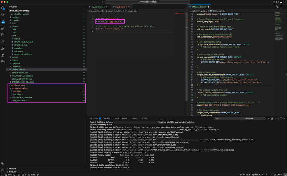

I have created an example project structure here that exemplifies this problem - I am attaching a zip file of it here.
Here shows the structure of what I'm trying to do:
So you can see my directory structure (which differs slightly from your example - I am using a series of nested subfolders in my shared code area). We can see that this project compiles fine - so cmake itself appears to be working.
(note: I have tried structuring the subfolders in my shared code area as separate Cmake libraries. So, each component gets its own CMakeLists.txt file. This produces some complaints from the ST extension, but it compiles fine. It does not solve my issue with clangd, however).

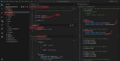

2025-12-05 9:23 AM
@sb_st
I've pain to get back your attached material

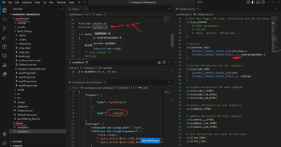

But anyway from my project trying to mimic your snapshots I'm getting
So works the same ok
Maybe this is not ok to you ?
2025-12-05 9:53 AM
@sb_st
I would be agree about "if nok to you" in real ...
I guess I've understood what issue is ... have to find proper solution then.
Moving to exact same as you my indexign experience is bad too and issue is reported Thanks clangd output channel trace:
Means because editing a file as part of shared area, clangd integration because multi root workspace is doing kind of project auto switch. No compile database is part of this shared project root so the stuff is blind not being able to index.
Maybe adding some CMake material as part of shared project is the key. Possibly https://cmake.org/cmake/help/latest/module/ExternalProject.html is helpful.

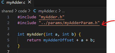

2025-12-05 10:16 AM - edited 2025-12-05 10:16 AM
Thanks @Cartu38 OpenDev, yeah your solution of using:
#include "../params/myAdderParam.h"instead of:
#include "myAdderParam.h"seems like more of a workaround rather than a 'real' solution (though I certainly appreciate you digging in to help me out with this!)
It does seem that this issue might be related to header-only shared code files. I don't seem to have problems with components in my shared code area that have .c files, because those become proper build targets, which seems like what clangd wants to see?

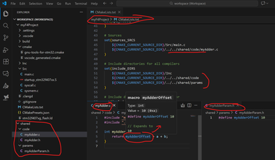

2025-12-05 10:38 AM
@sb_st
Source files (.c) are working fine because explicitly pointed as part of your project CmakeLists.txt. Header files (.h) are not ... reason why.
In real from clangd perspective none of them are processed right because project context switch ...

I understand.
I guess it's more-specifically correct to say that .c files work fine because they appear in the compile_commands.json file that Cmake produces...as I understand it, this compile_commands.json is what clangd is using to 'understand' things.
ChatGPT is telling me that one 'solution' here is to have a .clangd file in the top-level directory, 'above' both the project and shared_code folders. But this requires specifically pointing the shared_code area to the project, which sort of defeats the purpose of it being a shared_code area.
This is how I came to learn about adding this line to my workspace file:
"--compile-commands-dir=${workspaceFolder}/build/Debug"which only seems to halfway work.
