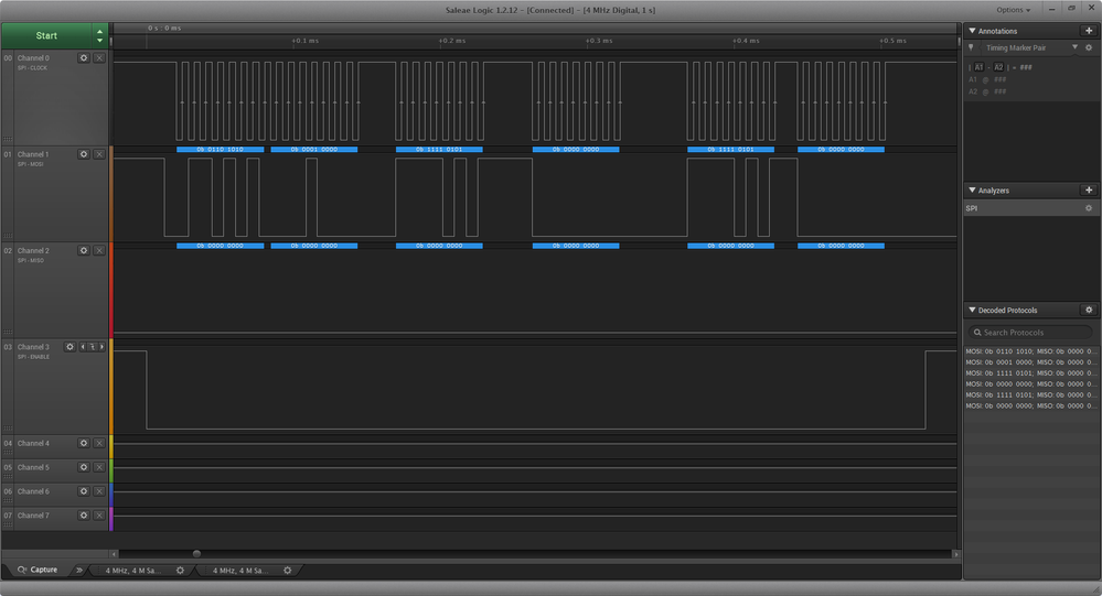

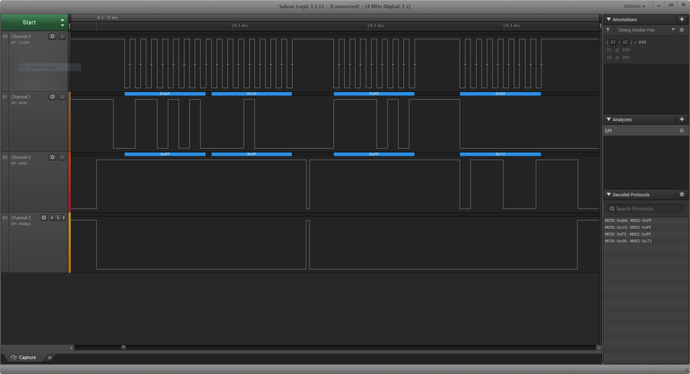

Here is a screen grab from my logic analyser:
- The first clock burst is a
HAL_SPI_Transmit() to write data.
- The second and third clock bursts is a HAL_SPI_Transmit() and HAL_SPI_Receive() to read a registers data.
- The fourth and fifth clock bursts are a HAL_SPI_TransmitReceive() to read the same register data as in the previous burst.
As you can see, there is no response on the MISO line when data requests are made. This is my problem and for the life of me I cannot find the issue. I have a feeling is is a configuration issue that I can't see because of lack of experience.

2017-02-08 2:12 AM
Hi All,
I have solved the problem. The MPU-9250 is by default setup to be an I2C device and so in order to communicate over SPI you have to disable I2C by writing a bit to one of the registers. I was doing this but was then requesting data without letting the device breathe. The cure has been to disengage the CS line after writing the bit to disable I2C and then to engage again and request data.
Thanks for every ones help, I much appreciate it!

2017-02-07 8:31 AM
Did you check the /CS line ?
It is not visible in your analyzer snapshot.
2017-02-07 8:57 AM
Thanks for the response!
From what I understand, the MPU-9250 doesn't support the 3 wire interface, only the 4 wire. The data sheet does say that one has to disable the I2C interface after start up. That is the first bit that I write in the code. Maybe I need to do a full device reset before trying to do any communication - will give it a go and report back.
2017-02-07 10:06 AM
Yes, It did check it. It goes active low before transmission amd then inactive high at the end. You cam see it in my original post - it is the 4th channel.
2017-02-07 10:15 AM
Do you measure those waveforms directly at the MEMS's pins?
2017-02-07 11:00 AM
Yes, probed on both the uC and the MEMS side. Same result at both ends.
