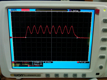

I am trying to implement the SPI1 by hardware in my STM32F407VGT6, I did everything and actually it seems to work. But I was trying to read the ID from my SPI device (which is a Flash Memory) and it doesn't work. So I used myoscilloscope
to watch the signal clock , and I got a CLK signal with a level on the bottom of it. Take a look, this picture shows my clk signal on my oscilloscope:
As you can see the Signal has a level at the moment to start the clock signal. So, What do you think is happening with this?, and what are the hardware considerations to implement the SPI?, Should I use External Resistors?

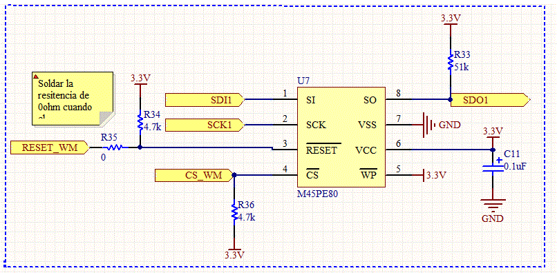

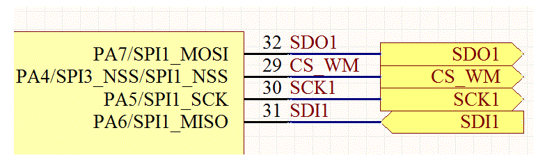

Thank you Clive1,
This is the side of the memory:2013-11-25 9:01 AM
The STM32 is the MASTER you have SDI / SDO wired backward
MOSI = MASTER OUT SLAVE IN MISO = MASTER IN SLAVE OUT LOW = ZERO = RESET HIGH = VCC = SET2013-11-25 9:27 AM

You're inject voltages into the output of the STM32? Do you think that might impact the IO ring supply? Try removing the serial flash and see if the clock pin behaves the same, or if the bandwidth of your scope/probe is appropriate. The chip select is active low, reset the pin to achieve that.2013-11-25 11:02 AM
Clive1 you are right,
The Signal clock is correct after remove the chip. But I have another question:

Are you perhaps using a 1x/10x probe in 1x mode? Check bandwidth of probe/scope.
2013-12-03 9:03 AM
Thanks Clive1, you were right again...
The wave was correct ... and everything is right after turn the probe test in x10...2013-12-03 10:06 AM
The bandwidth of 1x/10x probes in 1x mode is generally worse than useless.
