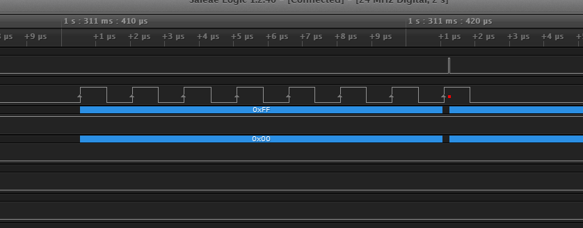

I am using bare metal STM32G441 SPI (no ST HAL or LL). It has been a very tiresome dilemma with the chip select. If I use the hardware NSS (Motorola mode) then I get a pulse after each byte. If I use software NSS then the last bit gets crippled because waiting for the busy flag or the TXE fires before the last clock is done.
So how does one properly transfer multiple bytes with SPI? At the moment I am polling for the last clcok pulse which is ugly.
while((SPI1->SR & (bit7|bit2|bit1)) != (bit1|bit2));
while((GPIOA->IDR & bit5) == bit5);
GPIOA->BSRR = bit4;

it has the exact same effect.
SPI1->DR = cn;
while((SPI1->SR & bit0) == 0);
dummy = SPI1->DR;
GPIOA->BSRR = bit4;It still goes hi in the middle of the last clock. The peripheral is unusable like this. Do I really have to poll while the clock pin is high to work around? This is a major fault of the CPU. How does one solve this the nice way?
Edit: changing CPOL and CPHA to 1 seems to work. But there is no long pause after the last bit.

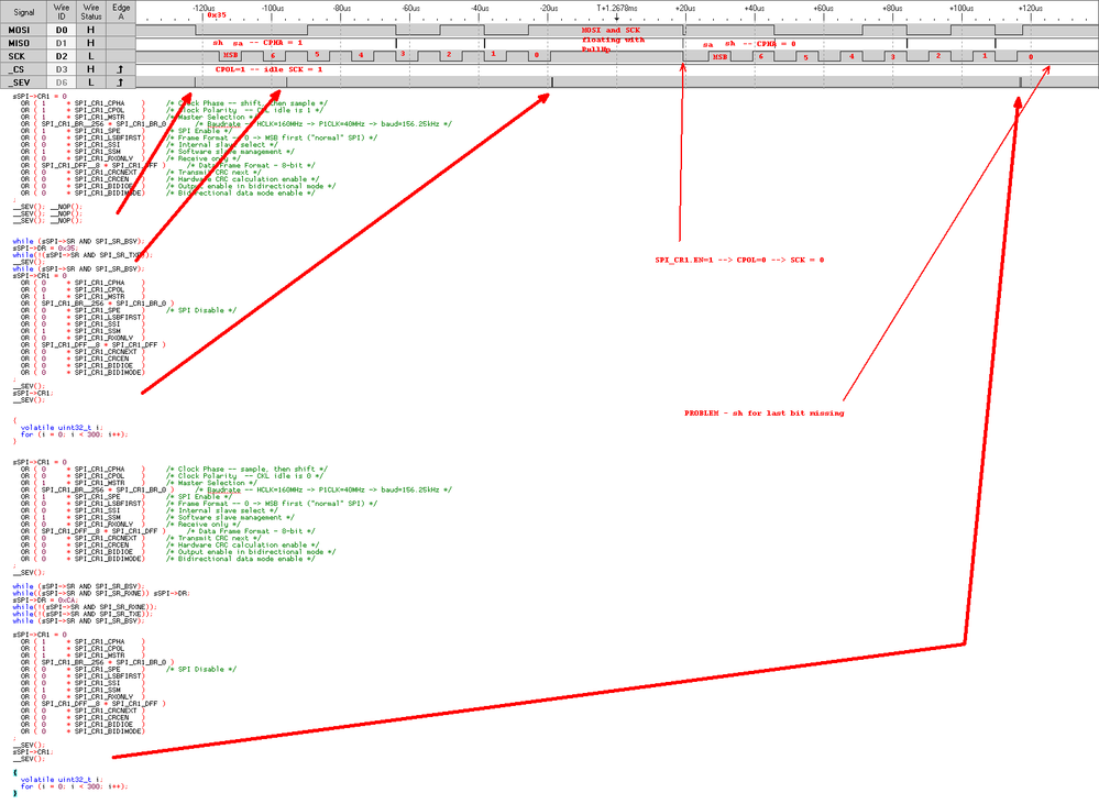

2023-01-04 4:08 AM
I conducted the experiment which is described in the linked article maybe a decade ago. Indeed, the second part of the waveform there clearly indicates that RXNE is not good enough with CPOL=0/CPHA=0... I need to update the text to say so explicitly.

2023-01-04 4:23 AM
Reviewing the old files I realized, that the problem is not BSY as such, but both RXNE and BSY behaviour with CPHA = 0. Using BSY with CPHA=1 apparently works as expected.
I need to revisit this more deeply...
