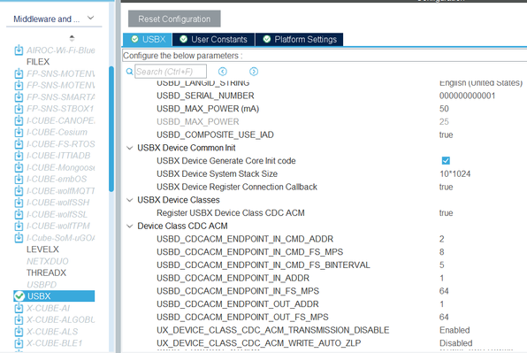

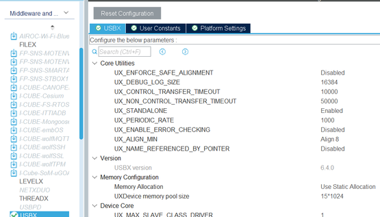

I have created a project, with the following configurations in the .ioc file;
Time Source : SysTick;

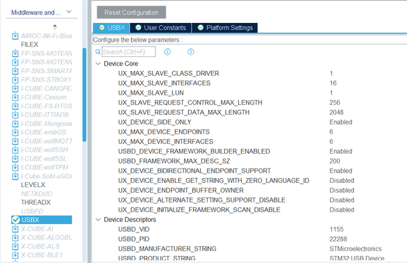

In Project Manager section, I have increased the, Minimum Heap size to 0x1000, and stack size to 0x600.

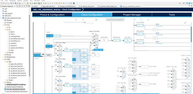

Clock configuration settings is as follows; (USB is receiving 48MHz through HSI48 clock).

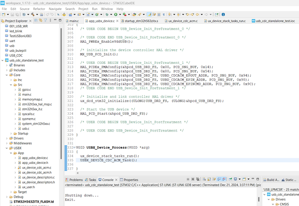

And I have created a task, USBX_DEVICE_CDC_ACM_Task(); for data receiving and transmission
and calling the USBX_Device_Process() function in main.c file, in while loop.

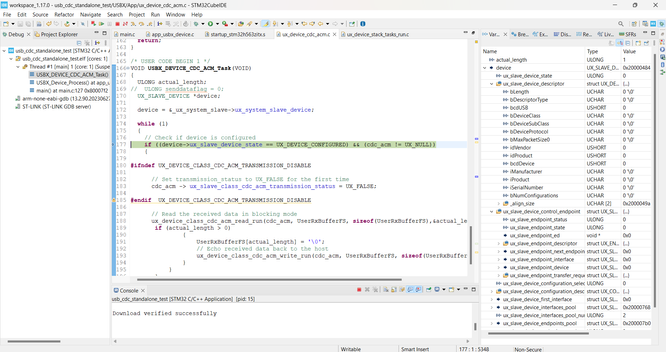

When I run the code, it's getting stuck inside the task; in line 177 as shown below;
(Even without the while loop inside this task, the code didn't work)
Seriously? You have PLL sourced from HSE.
2024-12-22 12:31 AM

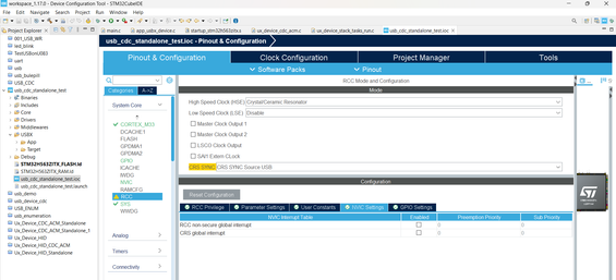

1. HSE oscillator mode should be set to Bypass.
2. USB FIFO configuration is incorrect - wrong last argument values in HAL_PCDEx_PMAConfig*** calls.
3. USB clocking with HSI48 is ok assuming you set CRS sync to USB SOF (which you did).
