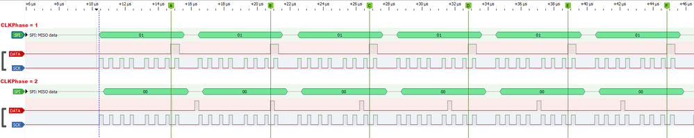

Init code (Only CLKPhase changes between tests, 1=Leading edge, 2 =Trailing edge):

}After starting HAL_SPI_Transmit, I send train of pulses.
The slave sends only 1s for easier detection.
CLKPhase = 1: Works ok. Also works with both clock polarities.
CLKPhase = 2: The data shifts and loses sync. Happens with both clock polarities.
I thought I was being too fast.
So I tried adding 1mS delay between clocks (Byte - delay - Byte - delay ...) but the result was the same.
Might this be related?
https://github.com/ARMmbed/mbed-os/issues/10589
Althought I checked the HAL code and it seems correct.

2021-04-08 6:54 AM
Yeah, I read them out a lot of times, both were exact the same at any given moment, only CR1 bit 0 ( CPHA, Clock phase) changed.
I think it might be a noise problem.
The SPI signal is not crazy high (1.7MHz), and the logic anaylizer sees everything ok, but I shortened a bit the wires and started working in both modes.
Or it might be a lucky shot, I'm still testing, will update later.

2021-04-09 3:02 AM
WQell, the culprit was the logic analyzer! Wires were not loo long, about 10cm.
But also they were plugged into a breadboard, that's asking for trouble at high frequencies.
The SPI worked well until I plugged the analyzer wires.
My problem was always at answering, (transmitting back).
Since I removed the analyzer everything is working.
I guess capacitance was too high or it caused ringing / signal reflection.
I don't have DSO right now, so I couldn't check the signal integrity.
Huh, try to see those things with the analogic one! :face_with_tears_of_joy:
The strange thing is that it always worked with clock phase 1.
That totally misleaded me!
