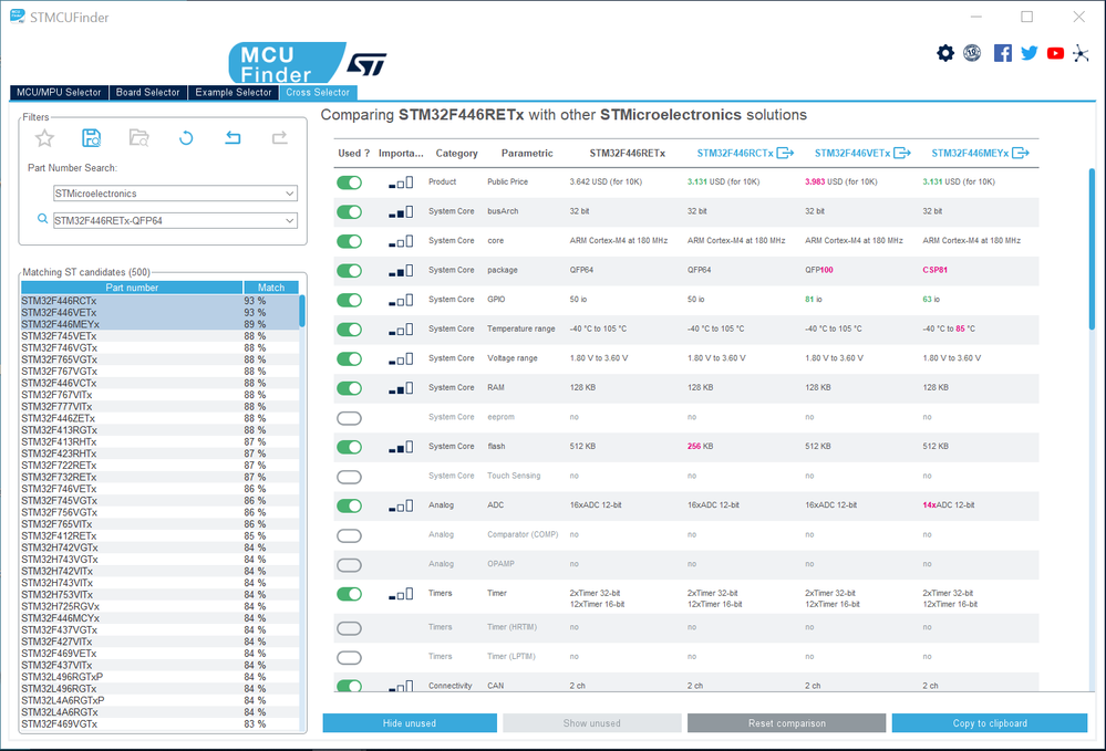

If I well understand your request, you're searching for a STM32 MCU that best matches your STM32f446RET.
So what I can propose here is to download and install ST-MCU-FINDER.
This application integrates the Cross Selector feature which allows you to find products of the STM32 portfolio that best replace the MCU or MPU you are currently using.
Hope this facilitates your search.

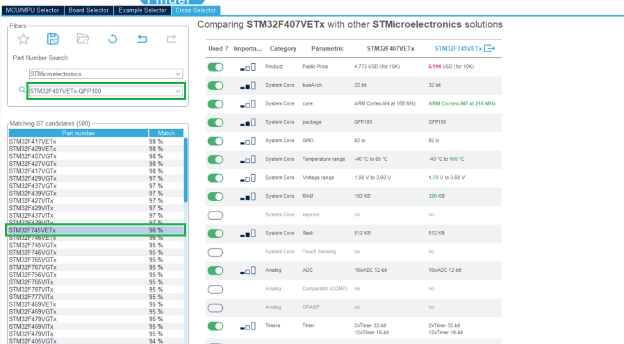

2021-04-08 9:42 PM
Thanks a lot :D
I can find that 'stm32f407VET' and 'stm32f417VET are compatible each other.
