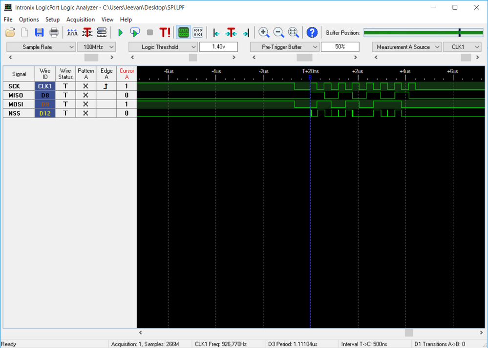

Output we have attached please look into it the NSS we are not getting properly either low or high.
when we made ST as Master.

SPI_NSS_SOFT and control NSS as if it is a normal GPIO, by SW.
Get NSS low before launching the transfer and wait that the transfer is really completed (RXNE completed and cell is not BUSY).
