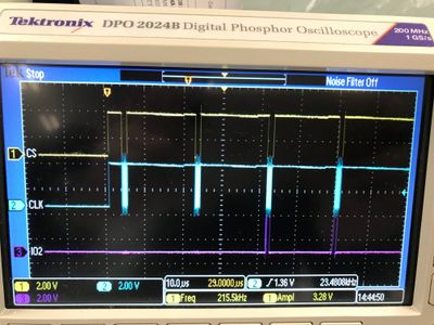

Hi I m using STM32H7 for SPI transmit & receive, the code is working and able to transmit 2 byte successfully as seen from scope, but the inital CS pin was unable to set to high from .ioc. CS = PA4 and set to GPIO output level HIGH and max output speed to Very high, but waveform show low at start and then high to low again... why is this so. any one can advise how to set CS to high then low initally..

Hi David, the SPI CPOL and CPHA was set to mode 2 i.e. high and edge1 but the clk waveform show start from low to high then low to init SPI ... why is this so? shouldn't it be showing starting high then low to init SPI?

CS pin inital state should be high then low to initialise the SPI.....
