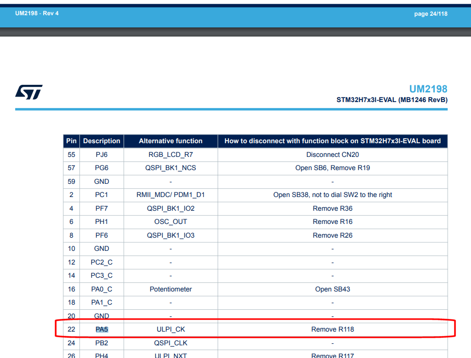

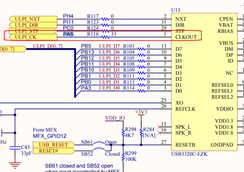

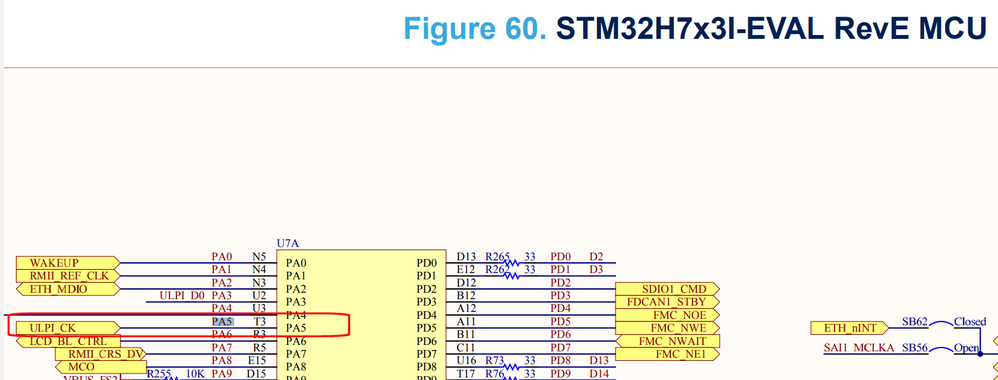

2025-02-25 1:33 AM
@Andrew Neil wrote:This: https://www.st.com/en/evaluation-tools/stm32h743i-eval.html ?
If so, did you remove R118?
also on the schematics:
2025-02-25 2:38 AM - edited 2025-02-25 2:39 AM
stm32h743i-eval2
2025-02-25 3:00 AM
So that is one covered by the Manual I linked:
So, again, did you remove R118 ?
If not, that explains why you couldn't use PA5!
