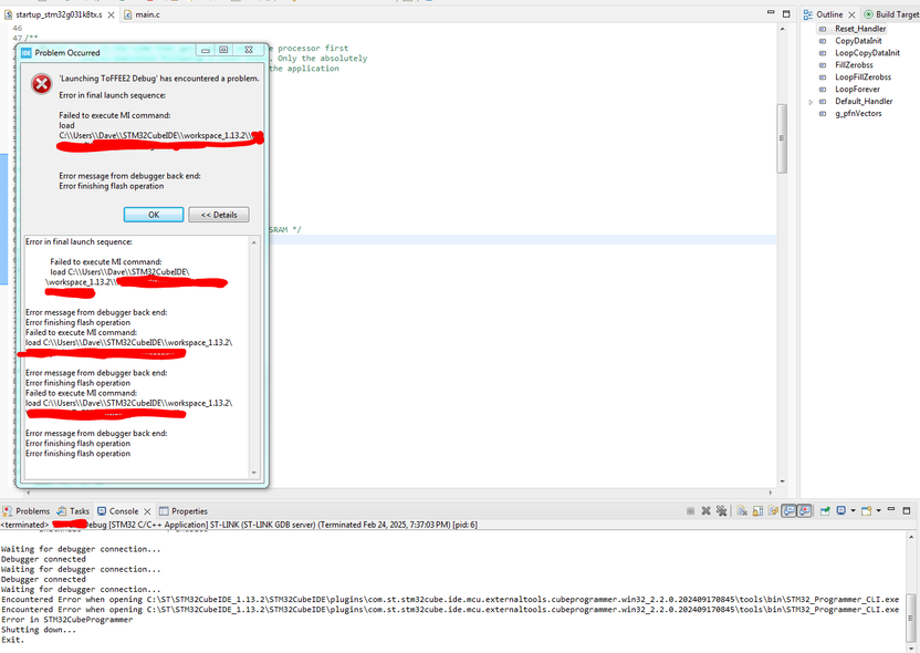

I know the dreaded 'Failed to load MI command' error has been much discussed on the forum but I can't find any posts which match this set of circumstances, so hoping somebody can help.
My project was working perfectly on STM32G0 but I need to port it to STM32C0. My IDE was at version 1.13.2 (I don't like updating unless I'm forced to and this is a good example of why) but C0 is a new part so I had no choice. It updated to 1.17.0 and of course that also forced an update to ST-LINK.
Now nothing works. I can neither debug nor run my previously working code on the target board, which I know is just fine. I've tried swapping the ST-LINK to a different USB port and also changing the port number in Debug Configurations to no avail.

Usually caused by debug or run configurations remaining from the older IDE version.
Try to create a new debug config from scratch.

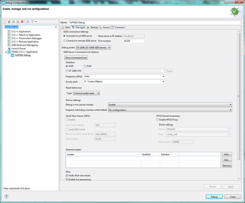

Try with setting: connection mode: software reset.
2025-02-24 4:41 PM - edited 2025-02-24 4:50 PM
@pretoriandave So you have created a 100% new debug config "ToFFEE2 Debug" and get the same error?

@Pavel A. yes I came to the same conclusion. Not on Win 11 unfortunately.
Is this anything to go by?....
It keeps popping up so I think it may be.
