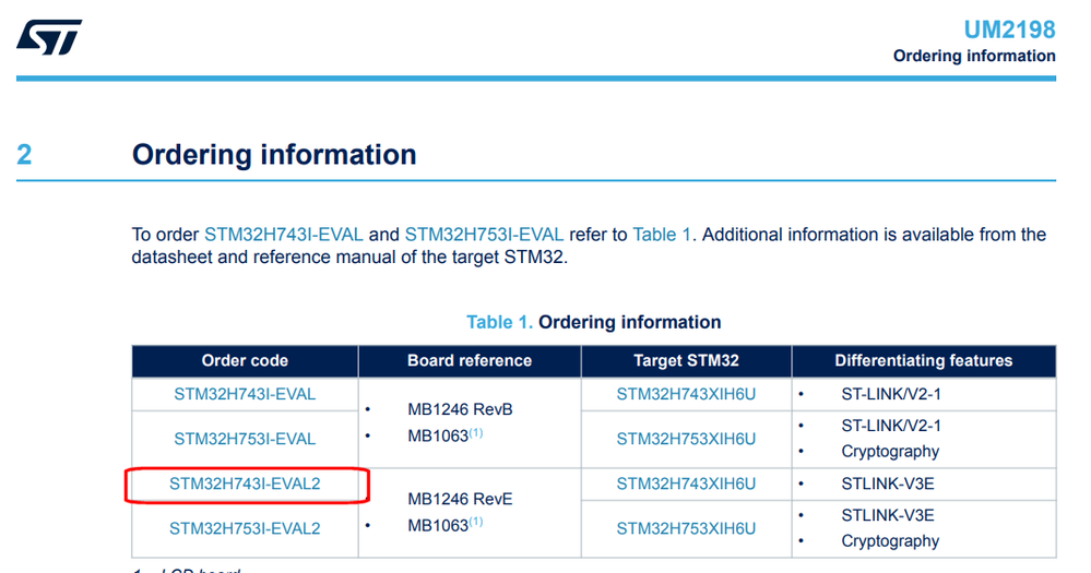

2025-02-25 3:00 AM
So that is one covered by the Manual I linked:
So, again, did you remove R118 ?
If not, that explains why you couldn't use PA5!

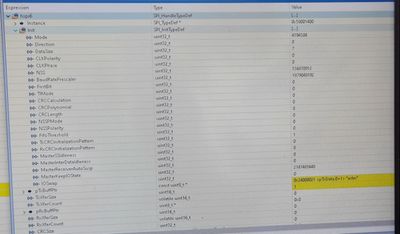

2025-02-23 8:56 AM
Show the contents of the SPI6 registers at the time of the error. Logic analyzer trace showing the issue would be good as well.

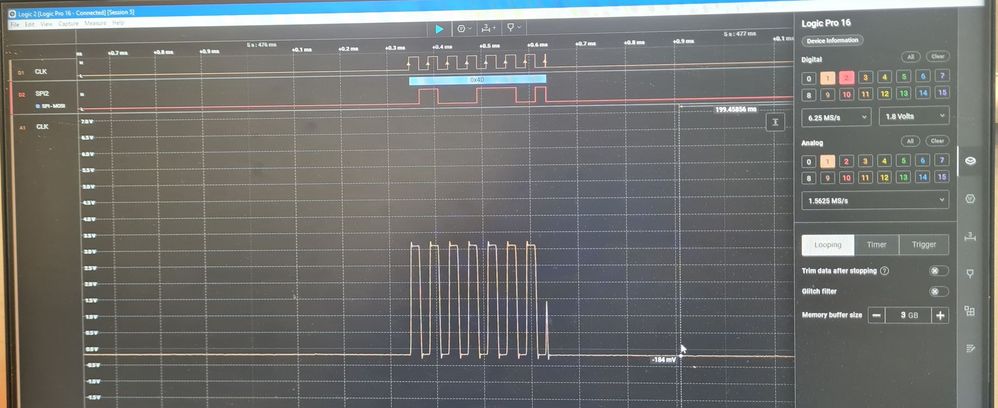

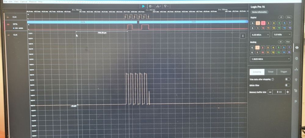

2025-02-23 11:28 PM
bad spi 5 bits on spi6
good spi 8 bits on spi2

2025-02-24 12:57 AM
2025-02-24 6:20 AM - edited 2025-02-24 6:20 AM
My guess is you're disabling the peripheral too early. Possibly when DMA completes but before the transaction completes. The SPI6 registers would be in the SPI6 instance, not the hspi6 handle.
In any case, your "8 good bits" are certainly not. Look at the clock line. There are 7 clocks plus a spurious edge/pulse on what should be the start of the 8th.
Showing the relevant code would be useful.
