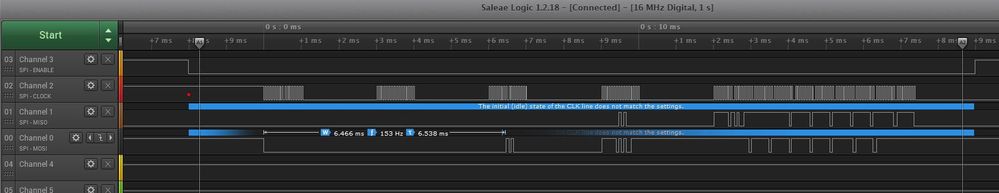

}and then i send by using this:
HAL_StatusTypeDef spi_status = HAL_SPI_TransmitReceive(&hspi1,0b000000000000, 0b000000000000, sizeof(uint16_t),0xffff);This is what the communication looks like, the clock line is initially high which in my opinion should be low. After and between the transmissions the clock line goes low as expected.
