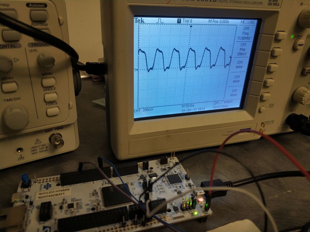

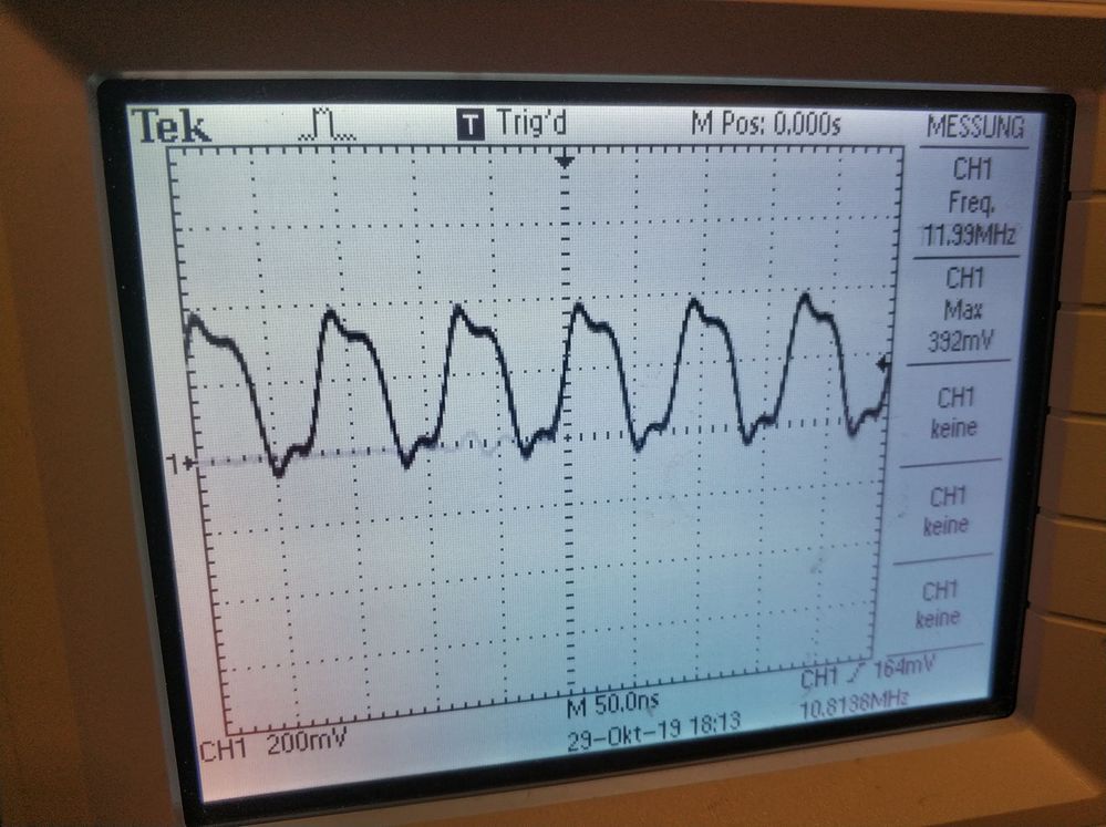

Hi I am trying spi master on the stm32h7 nucleo board, when I am measuring the spi clock it looks like it is only giving me 400mV max, can someone explain to me why and how to solve it?
Thanks!

A 12MHz signal should look better than that. What pin? Might be tied to something else onboard. What’s the bandwidth of your scope?

HI,
sorry turns out I had a wrong setting, now it is telling me 3.8 v
But the wave form still looks the same, is it supposed to be like that or should it be mroe like a square wave?
