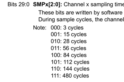

See rm...ADC :
So ADC needs 12 ckls for conversion, + time for sampling ;
min. 12+3 = 15, max. 12+480 = 492 clks.
At your chosen 21 MHz you get : 0.71 us ... 23.4 us conversion time.
So just select the sampling time that comes close to the conversion time you want.
(or adjust the adc clock in allowed range to get other conversion times.)
