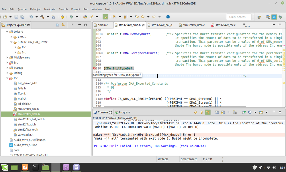

2019-10-28 11:48 AM
Thank you so mutch. This libs are the last puzzel parts. Now the code works.
Last question.
Can HAL and SPL co-exist? Because i get an error in the "stm32f4xx_dma.h" and in the "stm32f4xx_rcc.h"
2019-10-29 3:17 PM
After hours of reading documents. I know about SPL, HAL and LL. And how to solve my problem
