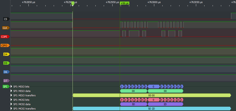

When I look at this with my logic analyzer, I am seeing this:
As soon as CS goes low, so does CLK. This doesn't make any sense to me because they are completely independent of each other. This causes an issue with the data. I am expecting the first byte to be 0xBA (10111010), but instead it is 0x5D(01011101)

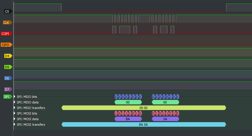

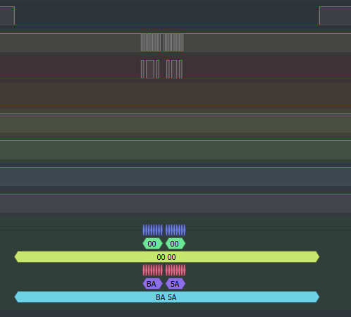

The equivalent output on the Arduino looks like this:

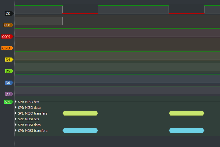

I just set CS to low, without an SPI transaction the same thing occurs:

2023-01-30 9:00 AM
And what's THIS supposed to be?
SPI1_CS_GPIO_Port->ODR %= SPI1_CS_Pin;
-> looks like a funny error, clearing the CS_Pin and all higher-numbered pins of a port.
I guess you want to implement SPI in software, right? Not a good idea with SPI hardware peripheral available.
BTW, do not use ODR for changing output pin state. Use BSRR and BRR:
SPI1_CS_GPIO_Port->BRR = SPI1_CS_Pin;
2023-01-30 9:28 AM
If this is an STM32 Nucleo board, there is an LED on SCK. You need to disconnect it by solder bridge or jumper depending on the board schematics, if this is the confirmed root cause.
