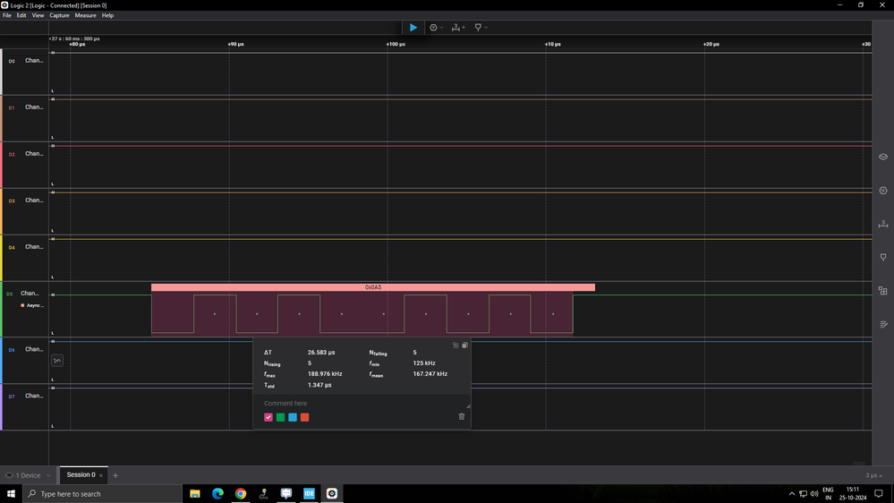

2024-10-25 2:42 AM
Hi, I am transmitting 0xA5 and it is measured on Tx pin of stm32. The usart settings are 9 bit and parity none.
USART_DATA[0] = 0xA5;
USART_DATA[1] = 0x1C;
in while:
HAL_UART_Transmit(&huart2, USART_DATA , 1, 500);
HAL_Delay(1000);
2024-10-25 2:43 AM - edited 2024-10-25 2:49 AM
looking at the last bit since the parity is none it should not be sending parity bit and since the 9th bit is 0, it should have read in space parity as well.
2024-10-25 4:07 AM
That's better info. I think you are sending Mark parity. Set bit 8 in your data, and try that...
