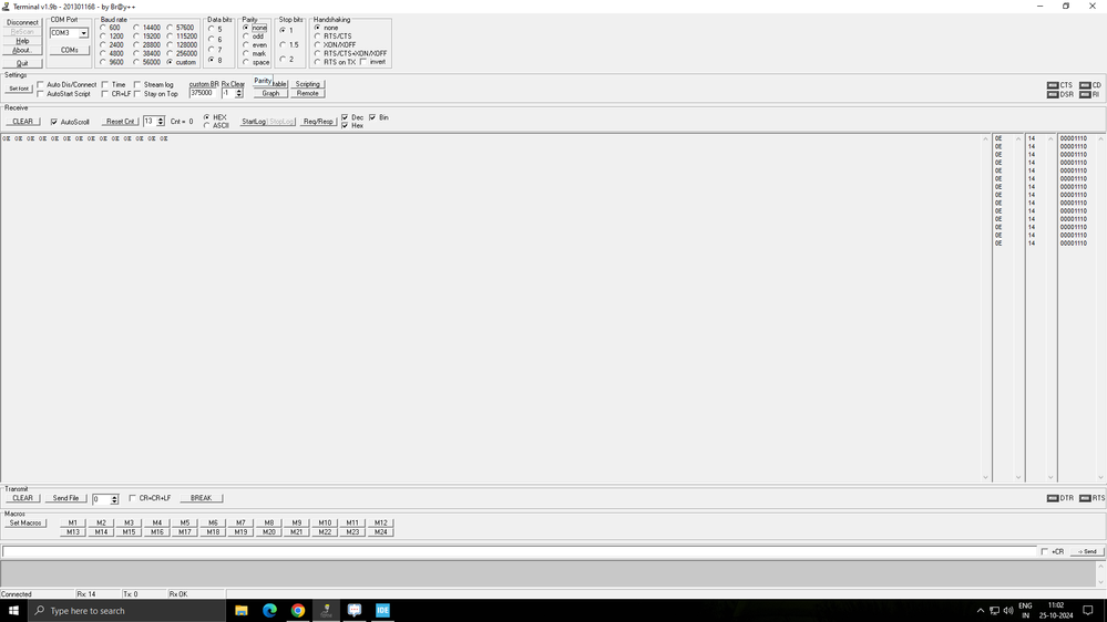

I tried that but in that case parity setting as NONE is working. I want it to work with space parity . Here is the screen shot of the terminal. when i set parity as none only in that case I am getting the data not under space.

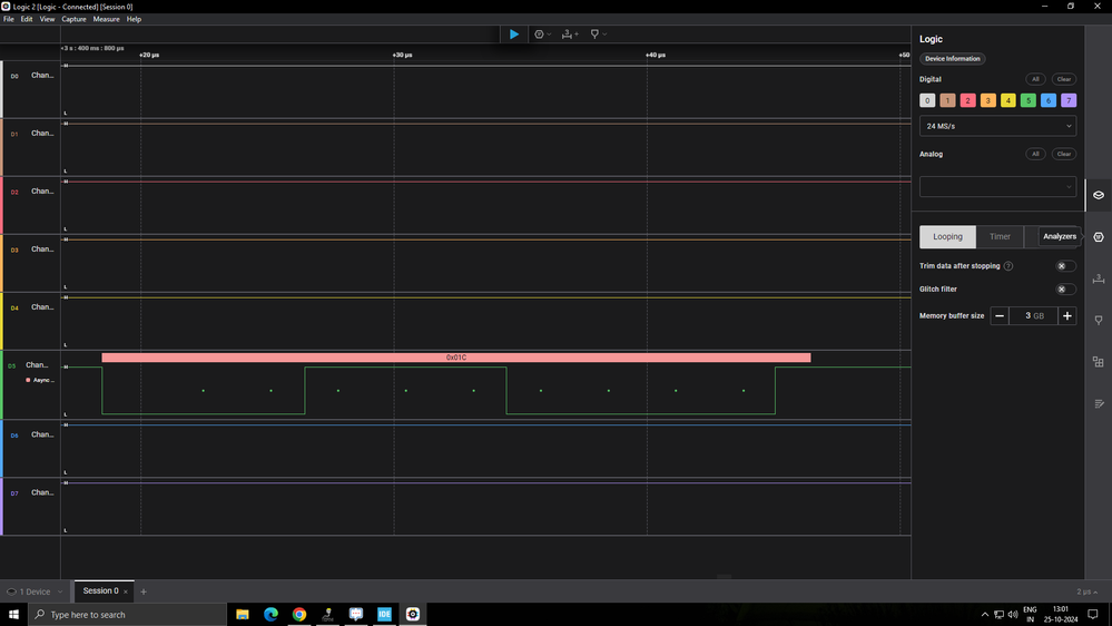

2024-10-25 12:32 AM
Hi, here it is, i am transmitting
