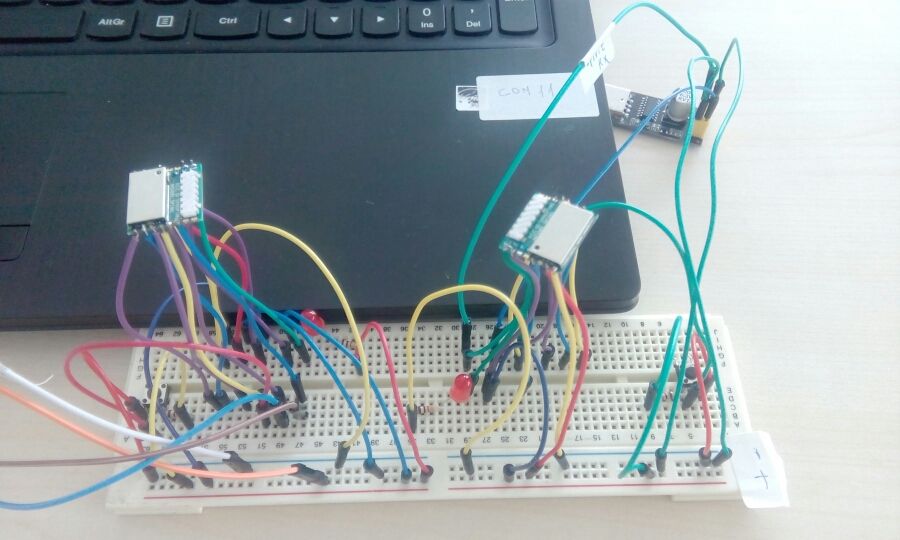

hello every body , now i could establish connection with my sp1ml using uart and i can communicate between two sp1ml just with hyperterminal using AT COMMANDS after downloading the standart firmware !!
now i need to bring that to my application using stm32f103C8 or CB for exemple ,
