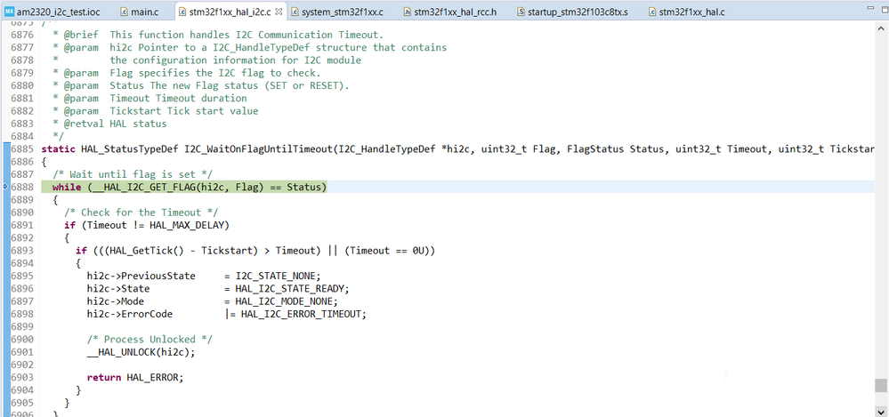

it still failed to transfer anything but it hung up at the line
while(!(I2C1->SR1 & I2C_SR1_SB));
This leads me to believe there might be a problem during the initialization, which I haven't tried doing using low-level code. This will be my next stop.

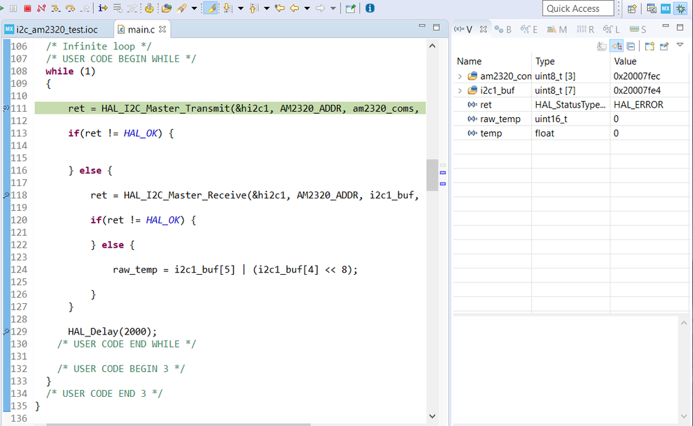

But I used the HAL commands for transmitting and receiving and so far, still nothing (Maybe I should use both low-level codes for next try?).
For good measure, I tried to repeat the experiment with another Blue Pill board that I bought just to make sure it wasn't hardware damage, and got the exact same results.
[Edit] It seems like when writing a 1 to the START bit in the CR1 register, it remains at 1 after exiting an I2C function. According to the datasheet, this bit should be automatically reset after a start condition has been generated, so it seems like it fails to generate the start condition.

[Update #3] I changed the pullup resistors to a different value, this time 10k. I get past the start condition generation, but then I hang up on the address acknowledgement. The resistors labelled as 4,7k were actually a faulty batch that were under 100 ohms. not sure how it survived.
[Update #4] I am actually capable of reading from the sensor and I get the correct values. I would still like to thank you for your time trying to help me out.
