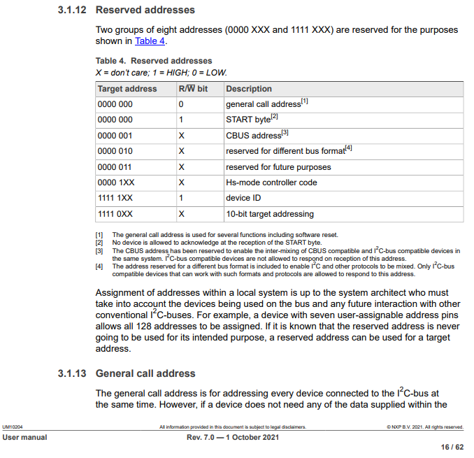

Indeed, addresses 0..7 are specified as Reserved:
https://www.nxp.com/docs/en/user-guide/UM10204.pdf#page=16

Change the slave address to something between 0x08 to 0x77. I believe addresses between 0x00 to 0x07 is does not conform to I2C specification
2024-09-27 2:19 AM

Yes, this worked thank you. Initially I had the address set to 0x50 but changed it to 0x00 in case it was causing an issue. I think there was an issue before adding the address issue with the external pullup resistors which was only fixed once i changed the address to 0x00 in the first place. It now works with 0x28 as the address. Thank you again this was a massive help.
