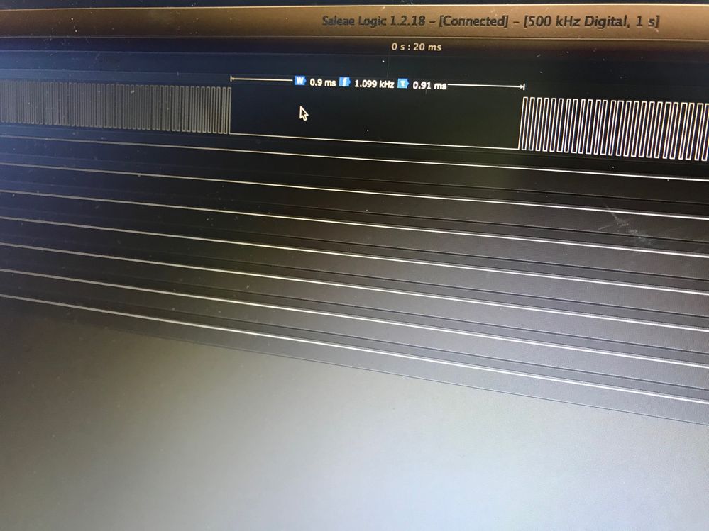

My issue is: When modulating the frequency, I get random drop-outs on the PWM pin, from time to time the output drops to ground for a while. When the frequency is constant I get no drop outs. I tested with F103 and F411, same issue...
See output read by logic analyzer:

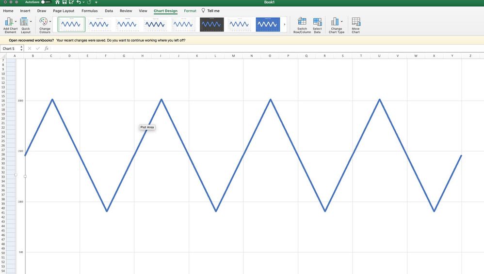

I am confident that my registers values for the timer are correct. I stored few periods in an array and plot them in excel:
So the issue is that I am changing the registers values over time. I am doing this with a frequency of about 1hz and the PWM frequencies are modulating from 35k to 80k. Where could it go wrong ?

Look at the value of the registers when you get the "drop out". If you set ARR=0, the timer stops running. And if CCR1=0, then you don't get any PWM. My guess is one of those is happening.
2020-05-25 8:38 AM
I thought so too but I double checked and they never leave the range between 900 and 2012.
