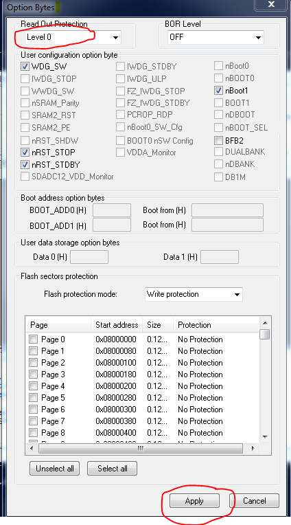

2017-06-13 2:45 AM
Hi
hosamane.dhanyakumar
,To disable memory read protection go to : STM32 ST-LINK Utility >Target > Option Bytes:
please refer toRDP (Read Out Protection) section on your reference manual to have idea about this type of protection
