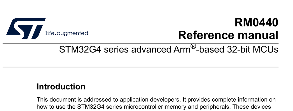

I'm talking about this document, it is the same for the entire G4 series.))
The CANFD module is the same for the entire series.
2025-01-22 12:07 AM - edited 2025-01-22 12:08 AM
Yes and FDCAN section is the same for many series not only for G4.Not possible to provide specific information for each product.
2025-01-24 12:49 PM
If they are the same, then the parameters for them are the same.))
