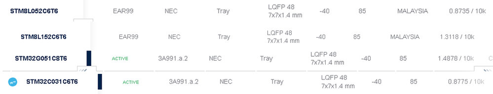

> The analog IPs are generally costly in size
Just to have some actual data points:
The STM8L152 buys against the STM8L052 not just 2xDAC and COMP, but also TOUCH. IMO there are applications where the cca 45cents price difference is worth it. I'm not sure the 'C0 vs. 'G0 price will get down to 45 cents, especially since the "smallest" 'G0 with DAC has extra features which may be useless for those lowest-end applications.
Speaking of STM8L152 vs. STM8L052 maybe analog is not THAT useful in the low-end applications, but touch IMO may be.
