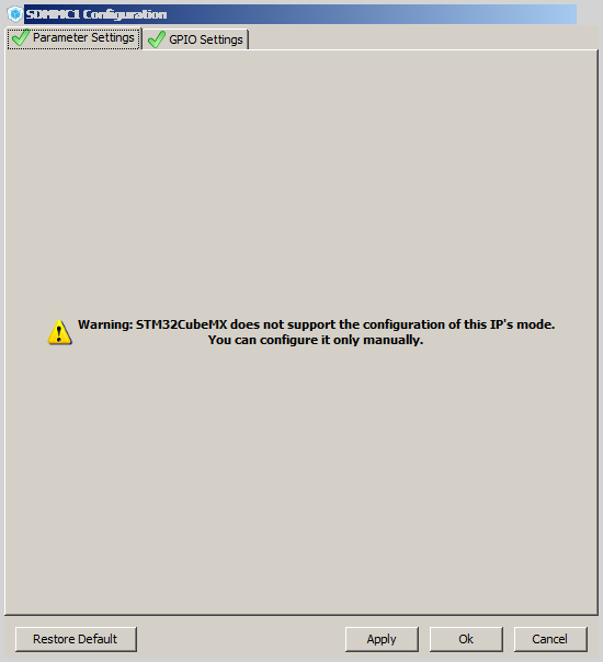

I am using STM32L452. I would like to interface with a SanDisk eMMC memory (
SDINBDG4-8G-XI1
).In cubeMX, when I configure the project and choose SDMMC1->MMC 4 bits Wide bus, I get the following:
Does that mean that there is no ready HAL functions? Or, for instance, can I use the SD 4 bits Wide bus for communication? Are those interfaces compatible in STM32?
I would appreciate all help.

In the end will need to do that probably. But with having no examples for configuration the task is harder. Do you know either there are any eMMC BSP for other STM32 family MCU's? Also, will this be supported in cubeMX for L4 in future?
DAHMEN.IMEN
?Also there is one thing not clear to me: For the L4 package i could find only the low layer MMC library, while F4 and F7 have HAL library. Are they compatible, or can I not use the HAL one for L4 device? This is additionally unclear, since in the cubeMX project options I cannot choose LL for eMMC but only HAL, which is not there...

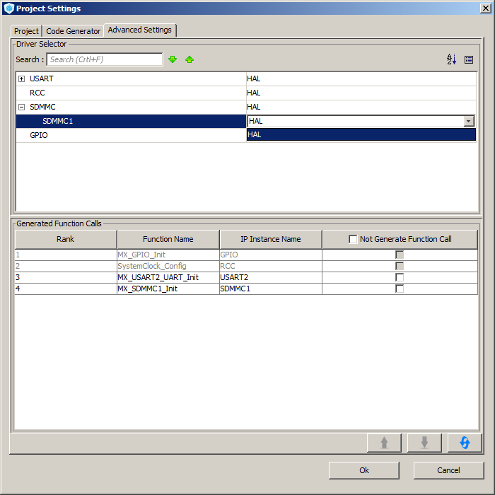

I have just created the cubeMX project and imported it to truestudio. The SDMMC1 init function generated is empty:
/* SDMMC1 init function */void MX_SDMMC1_Init(void){}It doesnt even consist of USER CODE BEGIN and END statemens to its not really usable.
