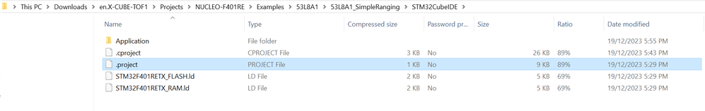

2024-05-08 11:47 PM - edited 2024-05-08 11:47 PM
Thanks for the quick reply.
It's when launching the debug session in the following file (as pictured) after downloading and unzipping it from the link (X-CUBE-TOF1)
I was following the steps from the quick start guide (attached) and was able to get the sensor working following flashing the drive with the binary file. However I want to add to the simple ranging project and hence was trying to open and run the project above. I was following UM3108 section 4.1.2.1 (also attached) but the file above already had all of the settings set as required for the 53L8A1 and hence I skipped steps 7 to 21 (as they were already set in this project file) but was then unsuccessful in being able to use it when it comes to step 23 (launching the debugger).
Please let me know if you require any more information :)
