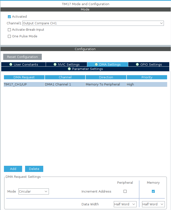

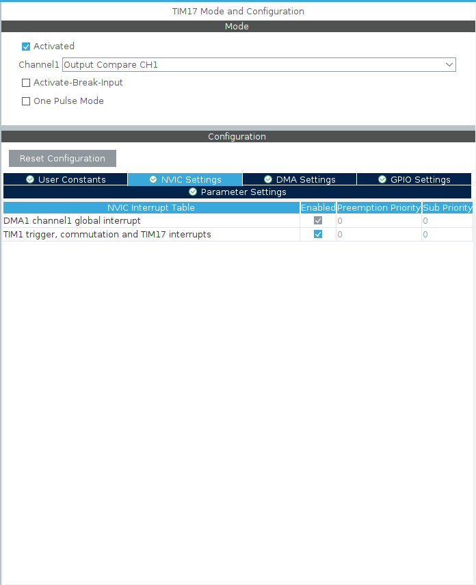

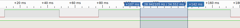

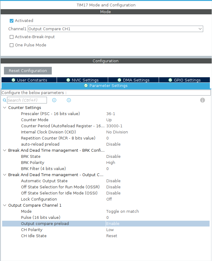

So far, the pin toggles but at intervals that are over the values in the array. Below is the waveform as seen on a logic analyser. I am certain that the input clock is correct at 36MHz and the period should be 33ms.
I have included the following functions to the CubeMX generated code to ensure the timer is started with DMA.
HAL_TIM_OC_DelayElapsedCallback(&htim17);
//enable dma
HAL_TIM_OC_Start_DMA(&htim17, TIM_CHANNEL_1, (uint32_t*)wave_buffer, 5);At this point, I'm not sure what I'm missing as I've followed the steps in the reference manual and application notes to be on par with what I need. I appreciate any help with what I may be missing, thank you.

I ran the code and I can see the output pin toggle, but it is nothing compared to the expected pulses. On reset, it just toggles at a period of 2 times the set period.
As for DMA config, I have that set as follows in the CubeMX generated file
/* Peripheral clock enable */
__HAL_RCC_TIM15_CLK_ENABLE();
/* TIM15 DMA Init */
/* TIM15_CH1_UP_TRIG_COM Init */
hdma_tim15_ch1_up_trig_com.Instance = DMA1_Channel5;
hdma_tim15_ch1_up_trig_com.Init.Direction = DMA_MEMORY_TO_PERIPH;
hdma_tim15_ch1_up_trig_com.Init.PeriphInc = DMA_PINC_DISABLE;
hdma_tim15_ch1_up_trig_com.Init.MemInc = DMA_MINC_ENABLE;
hdma_tim15_ch1_up_trig_com.Init.PeriphDataAlignment = DMA_PDATAALIGN_HALFWORD;
hdma_tim15_ch1_up_trig_com.Init.MemDataAlignment = DMA_MDATAALIGN_HALFWORD;
hdma_tim15_ch1_up_trig_com.Init.Mode = DMA_CIRCULAR;
hdma_tim15_ch1_up_trig_com.Init.Priority = DMA_PRIORITY_HIGH;
if (HAL_DMA_Init(&hdma_tim15_ch1_up_trig_com) != HAL_OK)
Error_Handler();
Now, I am not sure if that is all that is necessary since CubeMX has done a lot of the heavy lifting, but do I need to manually set the DMA peripheral/memory base address, direction or buffer size? Also, is there something I could be missing as regards implementing interrupts? I appreciate any help/advise with this.

I don't use Cube/CubeMX and don't try to understand your code, but IMO you want to do 6 transitions (toggles) per timer period, so you should have:
- 6 values in the table:
uint16_t wave_buffer[6] = {5700, 3000, 4700, 3000, 10000, 0};
- trigger DMA *only* from the CCx event, *not* from Update event
PS. Don't start new thread for the same problem
