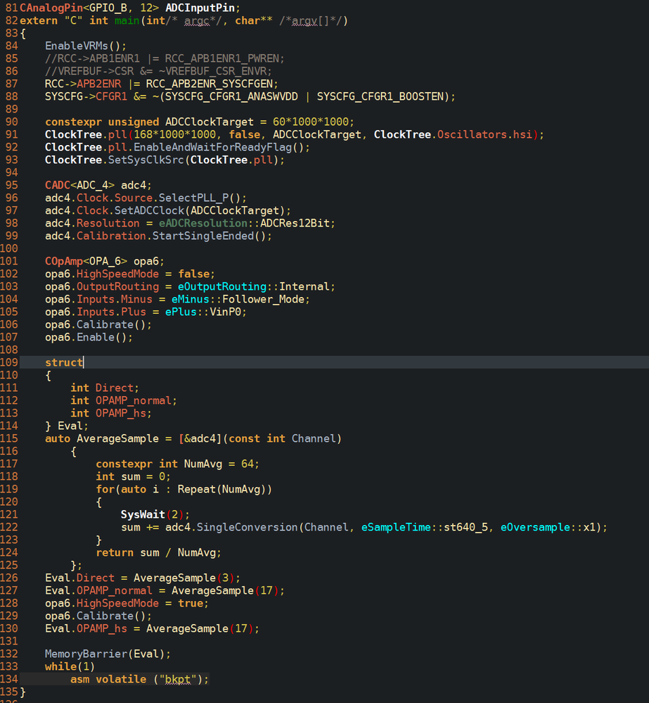

i have tried the PB12 experiment. I have attached all relevant code concerning the test procedure:
Well...
Eval.Direct = 1688,
Eval.OPAMP_normal = 1721,
Eval.OPAMP_hs = 1609No where near... :loudly_crying_face:
Reducing the ADC-Frequency from somewhere near 60MHz to 6MHz:
Eval.Direct = 1720,
Eval.OPAMP_normal = 1704,
Eval.OPAMP_hs = 1736Reduced effect, but still unacceptable. The change in the apparent absolute value is also a little strange..
There is some run-to-run variation of the ADC-readings. There might be some noise on PB12 in my circuit. However, no matter the values, the relative differences between measurement methods stay somewhat constant. Please consider the values above "representative". Especially have a close look at the influence of the OPAMP speed.
As you can see i am using my own C++ framework. It is entirely possible that i am missing an important bit/setting somewhere.. if so, it is practically undocumented or very well hidden.

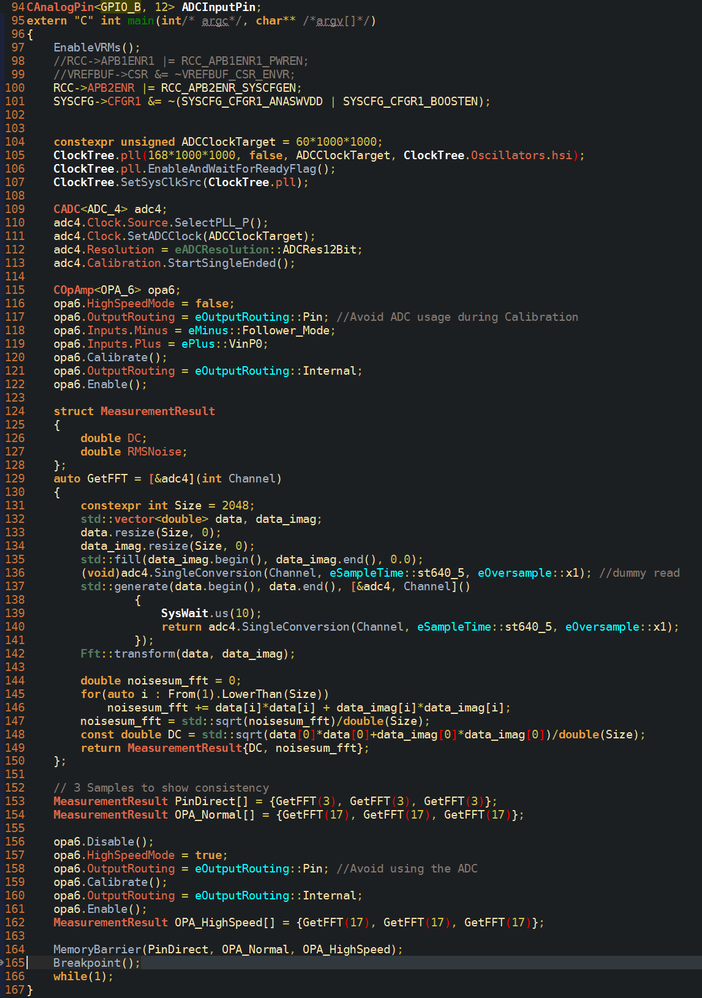

Concerning the weird OPAMP behavior: the new code for FFT analysis looks like
So i sample definitively quick enough (10µs artificial waiting time between adc invocations, Line 139)
The voltage at PB12 is 1.623V this should give an ADC reading of 2014.
The sampled data in reality is:
PinDirect.DC = {2107.349, 2107.374, 2107.426}
PinDirect.RMSNoise = {2.345, 2.297, 2.339}
OPA_Normal.DC = {2548.031, 2547.769, 2547.841}
OPA_Normal.RMSNoise = {3.308, 3.276, 3.203}
OPA_HighSpeed.DC = {1996.755, 1996.913, 1996.964}
OPA_HighSpeed.RMSNoise = {2.310, 2.32, 2.360}The measured pin is driven by an TLV9064 in my circuit. The sample time at maximum.
I dont think any DC value is acceptable close enough to 2014 +/-noise. The OPA in normal mode is totally kaputt, the Highspeed mode performs the best, however this might be purely by accident. However the the measurement seems repeatable and consistently wrong.
Now it becomes more interesting. I agree that due to my own software framework a register dump would be helpful. I challenge you to tell me which peripherals need to be dumped in order to get a full overview over the important settings. Maybe you name things that i have missed which would already solve the problem.

@Vincent Onde !!!!! I return in shame to tell you that i ****** up baldy.
Basically, because of the ADC register access is highly conditional (some registers may only be written under certain conditions), i gave up on keeping track of all the ifs and buts and flat out disabled the ADC to set up every single conversion in my SingleConversion(...)-function only to reenable the ADC and then trigger the conversion. AFAIK this is a behavior already covered in an errata or ADC related document and it should be avoided.
And indeed, keeping the ADC alive during all sampling makes all the difference. At least the OPAMP in normal mode is not crazy out of wack anymore. Still, i have some much higher than expected offsets, but there is an improvement.
I will add results later today.
