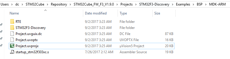

2017-09-02 3:43 AM
Thank you for responding.
Perhaps I am to novice to learn from this example. It seems a bit complex.2017-09-02 3:27 PM
