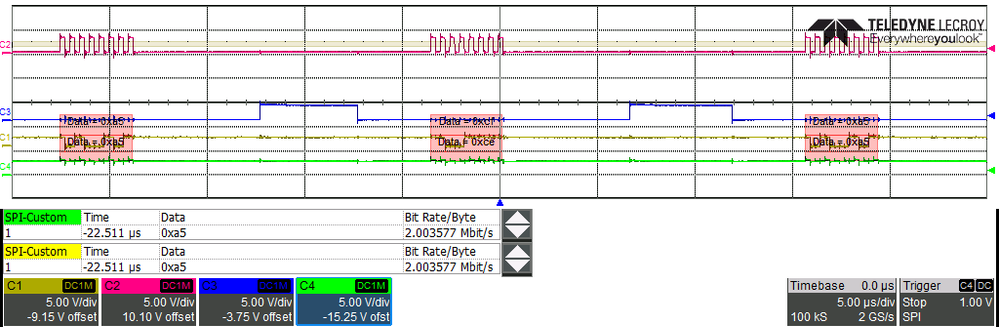

SPI_MASTER_CHIP_SEL_HIGH(); // slave deselect (high)This is what i see on the Oscilloscope. Also the Slave signal looks very strange.
Can someone please point out or give helpful tips why this is not working as expected?

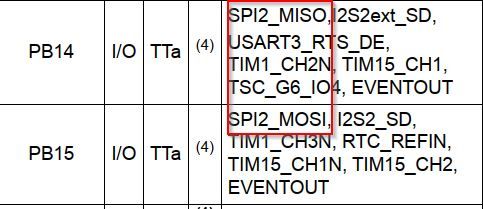

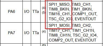

> SPI1_MISO (PA6) is connected to SPI2_MOSI(PB15).
This is incorrect.
MISO (Master In Slave Out) is an input for the master and output for slave. Don't cross them like you would for UART.

How are the signals connected to each other? From the layout it looks like you may have MOSI and MISO crossed.

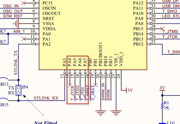

2022-03-04 12:28 AM
I am not sure I understand what you mean by "crossed". The signals are connected via female to female jumper wires on the Eval Board.
From the schematic, it looks like PA4 to PA7 are connected to SWD via Solder bridges. They need to be desoldered from the board, correct?
2022-03-04 5:59 AM
Yes, but is SPI1_MISO (PA6) connected to SPI12_MISO (PB14) or SPI2_MOSI (PB15)? As I said earlier, the table you present suggests you are connecting MISO to MOSI if each row lists a connected pair.
You are looking at the ST-Link chip, not the target MCU. Also, PA4 on there is free/disconnected. The signal name is above the signal as a convention, so T_JTCK is on PA5. The "X" on the PA4 net indicates it's not connected to anything else on the board. Same for PB1.
2022-03-07 6:04 AM
SPI1_MISO (PA6) is connected to SPI2_MOSI(PB15). Is this incorrect?
Yes i had a closer look at the schematic, you're right. In that case, I believe the SPI (Master+Slave) Pins are available for use.
2022-03-07 6:08 AM
This is incorrect.
2022-03-07 6:28 AM
Yes, now i see the expected bytes. If i were to use a another chip as slave, then it would have to be crossed, correct? "Data In" Pin on the Slave Chip would be connected to "MOSI" line of Master Chip.
Okay, then my understanding was incorrect. Thank you.
