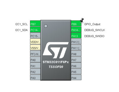

I have created my first PCB with a STM32C011F6P6 on it, but I am not able to measure a GPIO I set high from my testpoint.

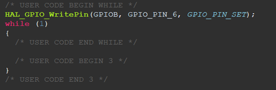

I am setting PB6 high the following way:
I flashed the code to the MCU via the cube ide and it told me that everything went fine.
This is what cubemx generated for the gpio init:

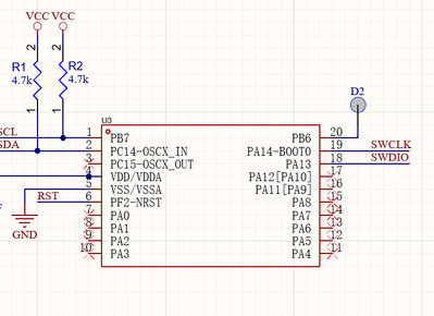

}I have it wired the following way:
Where PB6 is exposed through a test point. Measuring the voltage at that test point, or directly on the leg of the chip tells me that it is connected to GND though, instead of being set high.
Am I missing something?
2025-02-04 12:11 PM
There was a short on the test point to GND.
