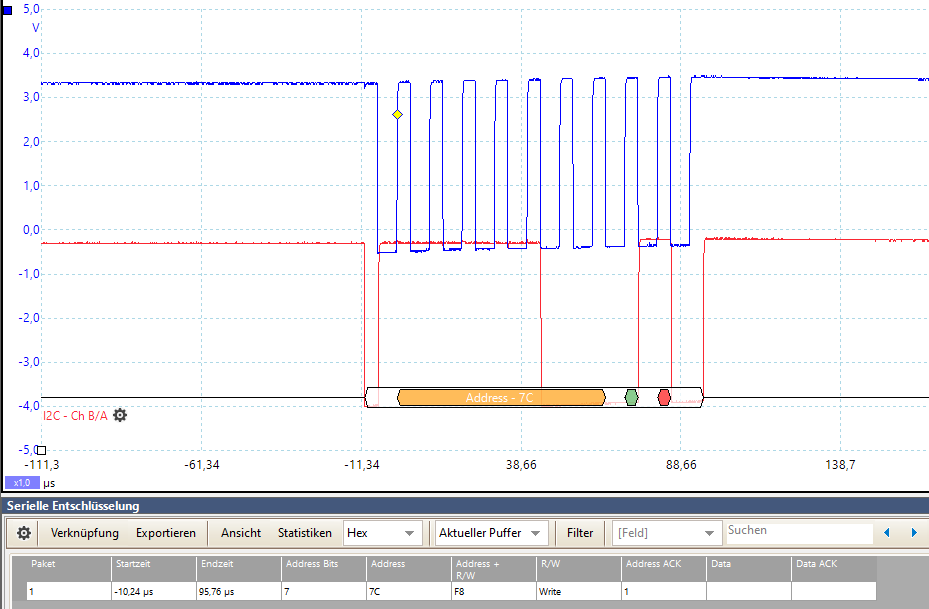

I want to controll a ST7032 Display Modul via I2C with a STM32G071G8 MCU. Unfortunately I can't manage to send data bytes to the Display. For sending data I use the HAL function HAL_I2C_Master_Transmit() as followed: (for testing)
HAL_I2C_Master_Transmit(&hi2c1, 0x7C<<1, buffer, sizeof(buffer), 1);
HAL_Delay(1000);where buffer is an array with two uint8_t values.
The code above is looped every second for testing because I cant see data transmitted on the line. The following picture shows what can be seen.
The Display controller seems to ACK the Adress but the MCU stops to send data.
Does anybody knows the mistake?
thanks for your support!
Henning
2020-09-23 3:06 AM
Solved it!
Missunderstood the datasheets adress information. Shifting the slaves adress is not necessary. So now I'm able to send data.
