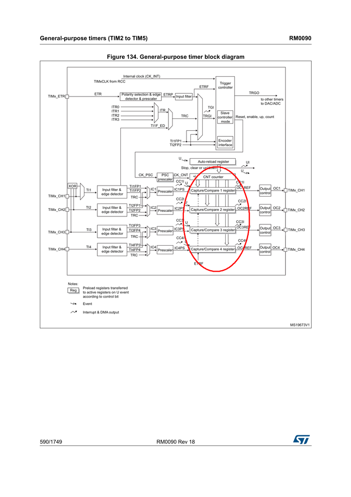

I'm not even sure if I know enough yet about STM32 but on AVR MCU I'm using input capture so an interrupt is generated on say rising edge save that time reconfigure timer for falling edge and subtract the 2 times to determine the pulse with on the GPIO pin. Output compare the MCU generates the timing of the pulse .
2019-10-24 11:44 AM
You can get the processor to interrupt/latch on either/both edges (for the most part), you can also cross-feed (indirect) onto a second channel such that one pin can latch CH1 and CH2 on opposite edges.
Also there is a PWM Input mode, pairing CH1/CH2 and reset such that you can get one interrupt and compute Period and Duty, or just read the registers to see the most current measurement.
The TIM are probably the most complex part of the STM32 design.
Remember there is a single counting element, and four latches to either capture the current count, or trigger on a count comparison. You can mix channels between capturing or comparing.
