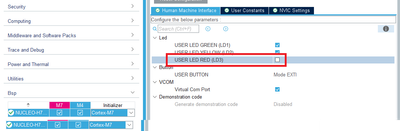

For CubeIDE/CubeMx, I think you've started your project based on the board and you activated by default the BSP which leads to set PB14 as LD3.
So in "Bsp" tab, uncheck LD3 option:
Hope that answers your questions.
