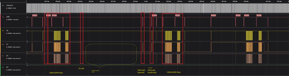

This really led me down the rabbit hole and led to some close scrutinizing the logic analyses.
It turns out that given the D1 interrupt is sent from the slave thusly. (SDIO slowed down to 1Mhz)
The overall throughput is heavily compromised by those 'missed opportunities'
The D1 interrupt is never picked up by SDIOIT (even at this slow speed).
As you can see the D1 interrupt is never sent during the data sequence and therefore according to the SDIO literature - the STM32 should be able to handle the transition.
