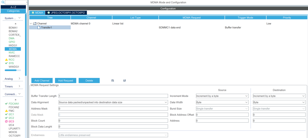

    • Do I need to enable the MDMA or something similar like DMA Streams in the original example? (when MDMA was enabled as on image its callback was never called)
