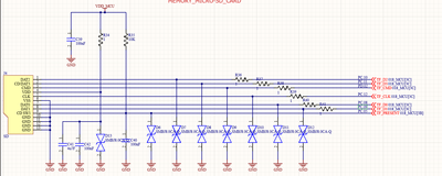

I had a custom board and my SD clock (SD_CLK) is always stuck at 400 kHz, this is typically due to the initialization phase of the SD card interface. As such i unable access the content in my SD card.
How is a clock rate of 400 kHz preventing you from accessing the content on the SD card? SD functions will work at this clock rate.
2024-10-07 7:28 PM
from mine understanding, when it remain 400khz, it still in initialization stage haven't get into ready mode. I try to hardcode it to desired freq but still not function properly
