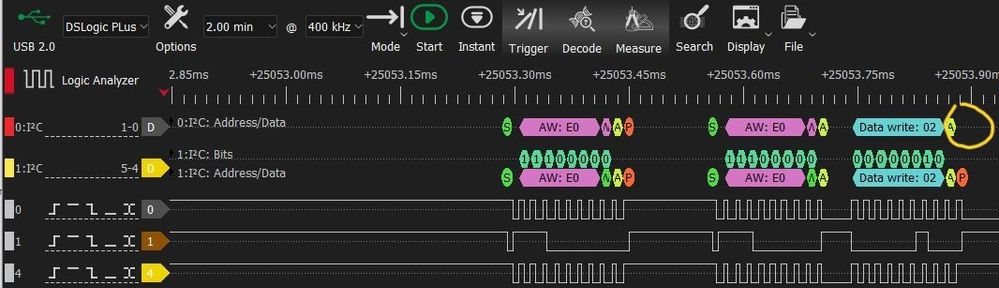

I have highlighted the missing STOP bit. Channel 0 is the SCK line connected to the Nucleo board. Channel 1 is the SDA line connected to the Nucleo board. The yellow output is connected to the SDA line of the 1:8 mux chip (TCA9548A).
From the image it looks like the Nucleo isn't setting the Stop bit. What can cause this?
Thanks,
Richard

Hi, RCooke88,
There are some concern for your problem:
1. The waveform no good, I can't see detail for second byte last clock SDA status.
The I2C bus requested, SCK high time, SDA have to keep stable except start bit, your wave form show second byte last SCK and SDA change same time.
Please look for attached file page 7.
2. You send first should be control command, you enable three channels, this may cause problem.
Regards,
