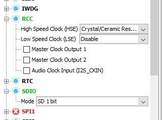

I've been trying to get an SD card working in 1bit mode using the SDIO peripheral. I am failing, and would appreciate some help. I'm on a Nucel401RE using STM32Cube_FW_F4V1.180.0

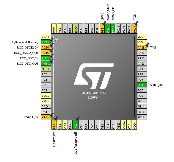

The pin configuration is below. I have not enabled anything else

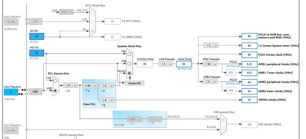

My clock configuration is below. I've not configured anything else - including any interrupts. (sorry for the small font HCLK is 84 Mhz)

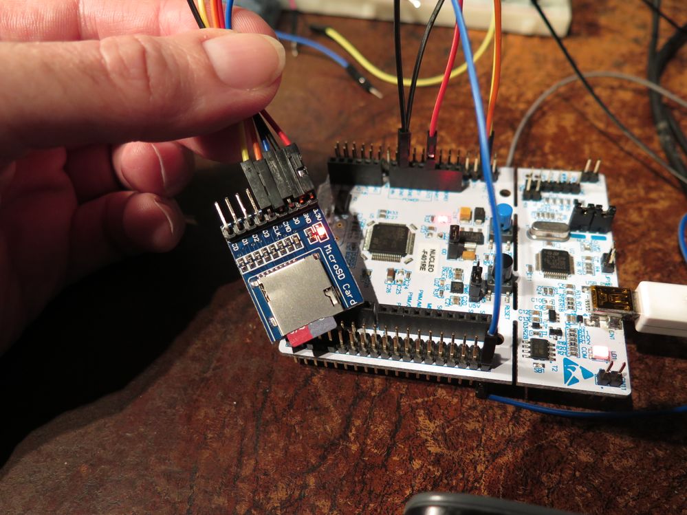

SDIO_CMD, SDIO_CK, and SDIO_D0 are connected as you might imagine. The breakout board includes some pull ups.

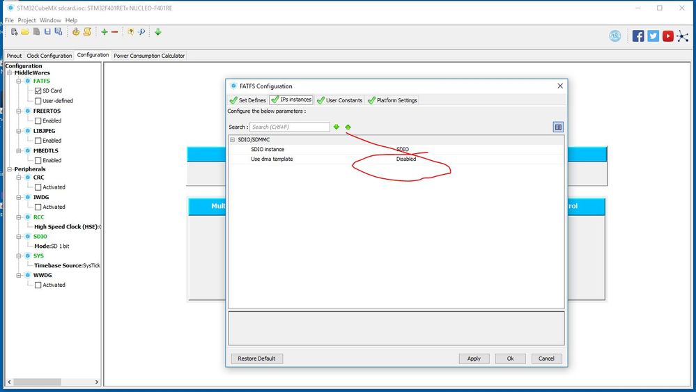

Problem now solved, I needed to set Stm32Cube\Configuration\FATS Configuration\IPs instances\Use DMA template to 'disabled' - and then it worked!

2017-12-04 2:39 PM
You'll find it in STMCube, go to the configuration tab, and choose the configuration for the FATFS, and then it's in the second tab along (IP Instances)
