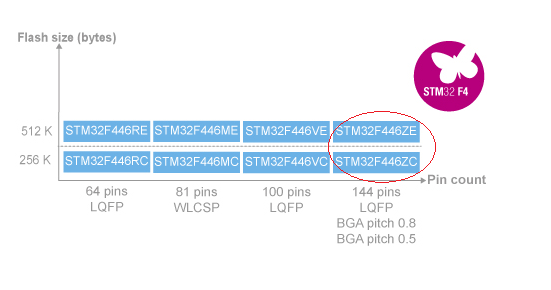

2017-01-23 2:41 AM
Nesrine,
I went to the
http://www.st.com/en/microcontrollers/stm32f446re.html
and it saysI also opened the datasheet, DocID027107 Rev 6, and in 3.9 Flexible memory controller (FMC) it says:
All devices embed an FMC
2017-01-23 3:13 AM

,In the datasheet page no:-13 it is mentioned that
UFBGA144(
STM32F446Z
) andLQFP144(STM32F446V)
packages only support FMC, but i dnt know why it mentions all device have embed FMC.Regards,
